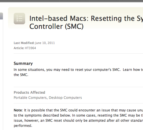

the link for resetting the smc is not working...what does that do?

Resetting the SMC can correct fans spinning up without increased heat. The link is good, try again. You might try clearing your browser's cache and cookies.
