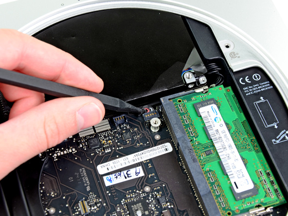

Sounds like you've knocked the temp sensor cable off the hdd it's just inside by the ram. If you download istat youll see an off reading.

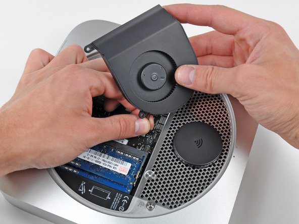

I doubt its the SSD. The first thing I would do is open it back up and make sure all your connections were pushed all the way back in (also check ram placement).

That has to do with custom firmware on the iMac's internal hard drive. The Mac Mini has separate temp sensors that attach to the external HDD housing. That is not the issue that you are having.
You either did not plug in an additional temp sensor when you installed the added SSD or you just don't have everything plugged in all the way.

If i had to guess, I think it would be a damaged fan cable (just took mine apart for the first time yesterday, never realized just how fragile everything inside is).

Sounds like one of the sensors connected to the logic board may have been broken.
