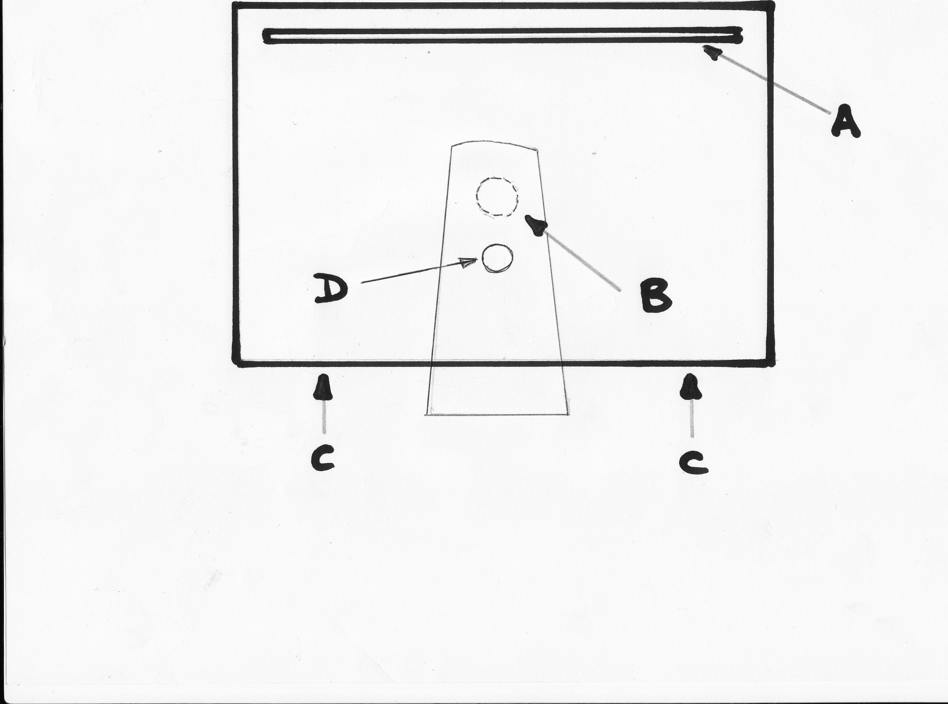

Ive been wondering about the cooloing on the new iMac , have I got this correct..
A= Exhausted air
B = ?
C= Air intakes
D = Power cable access
Any Idea what '' B '' is ..?

Have I got this right then , if I raise my desk fan to the same height as the Exhaust air vent ( A ) and angle the fan to blow across the vent , this will help pull out the vented hot air and hopefully in some way help my iMac to cool down more
Does any one know what the small round hole in the back case ( B ) is for ?

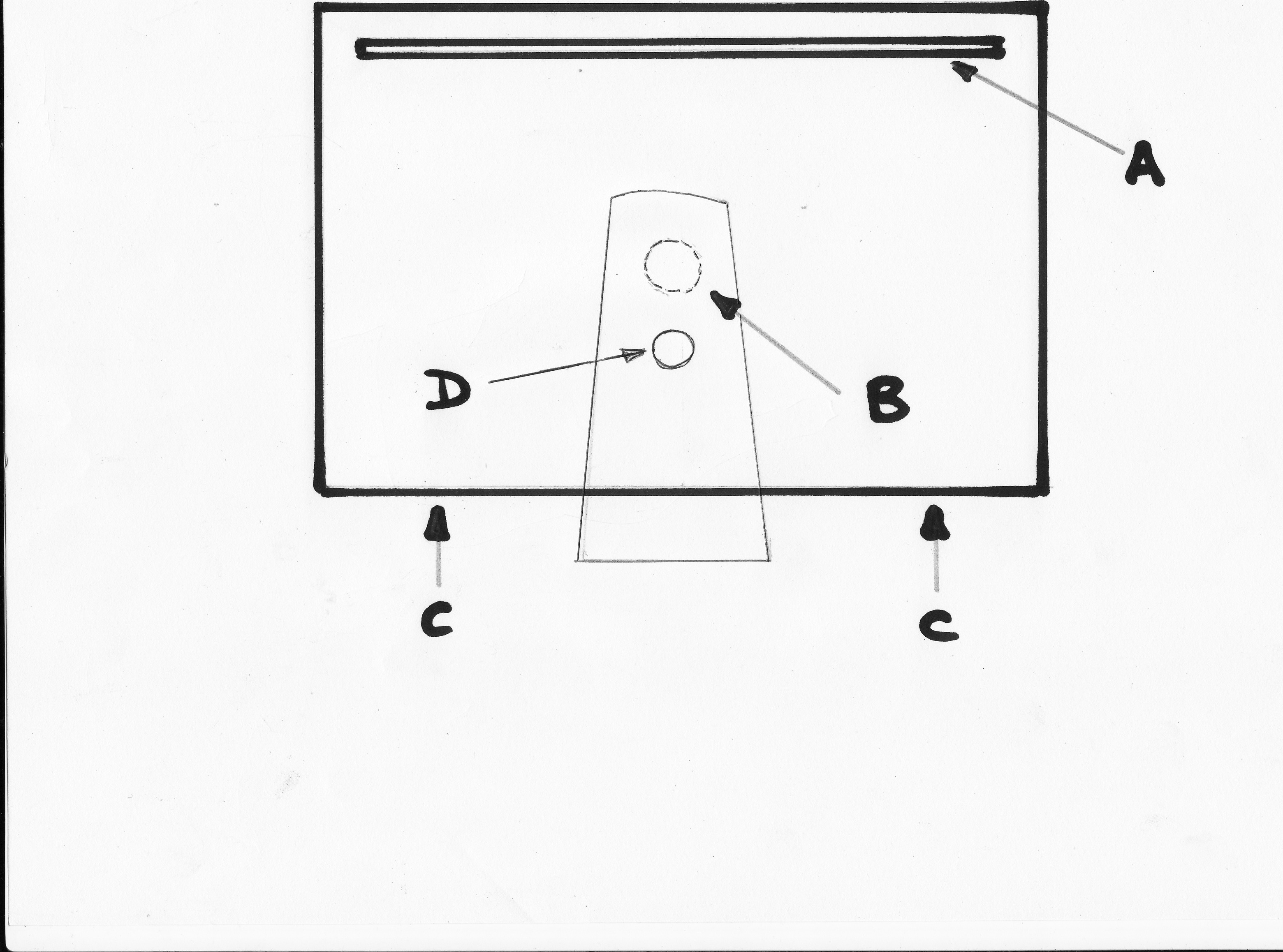

A= Exhausted air
B = ?
C= Air intakes
You could easily answer your question just by putting your hand near B. If hot, its the exhaust, if cool, its the intake. But I'll save you the trouble of this hard work and say that its for additional air intake...
I'm not sure why you so paranoid? Unless you're in 50+ degree C environment I don't see how your iMac overheats...
As I sit here the morning ambient room Temperature is 42 oC with all my windows open , Ive just leaned over the iMac to put my hand over the small round hole on the back, as you suggested and now have a red burn mark on my arm from touching the top of the iMac , and I cannot feel any hot air coming out of the small round hole. sorry to seem some what paranoid , but I must go and have a closer look at my arm.
