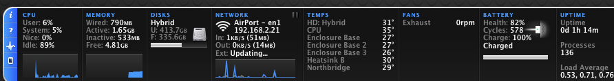

I've read that it might be the Thermal Sensors on the logic board, not sure how to tell? (Istat has 7 temp's listed, none currently above 35c but mac sounds like a jet plane)
Istat pro says exhaust fan 0rpm, Smcfancontrol doesn't work.

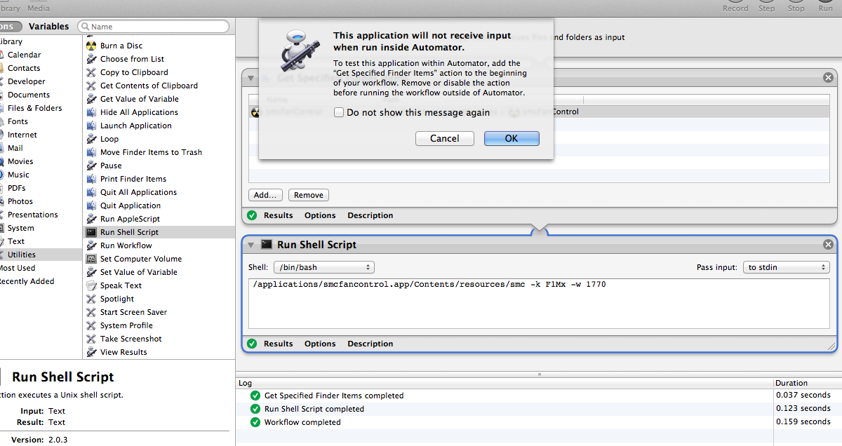

Try this and see if it works.
Controlling the fan speed in Mac models after an SSD upgrade.

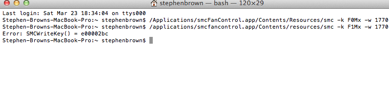

Tried the Automater thingy, didn't work, but probably because not using it correctly.
Also saw somewhere else to try in Terminal, but didn't do anything (fan still going strong), but didn't return an error code like what you put in Automater.

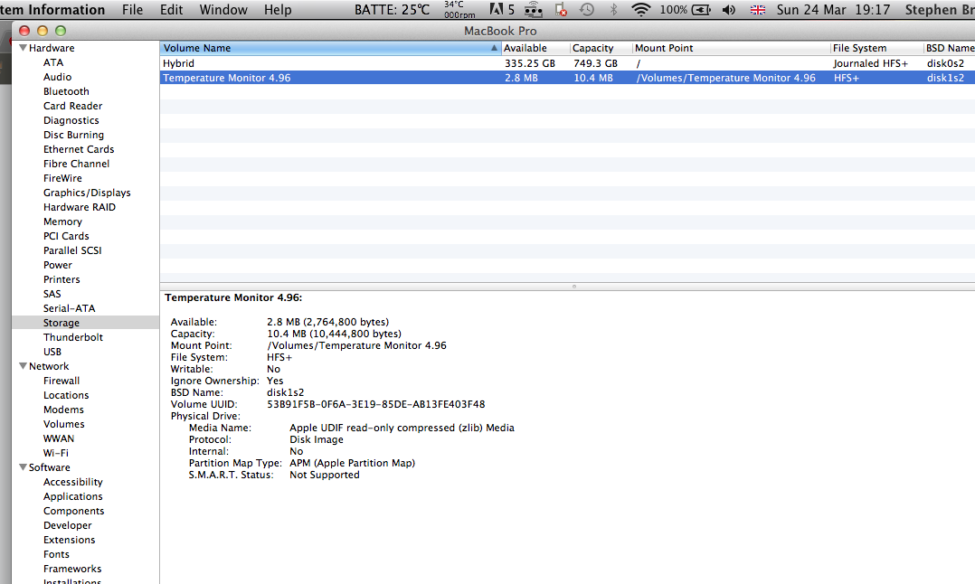

Had a look for the sensor, couldn't see anything. Not sure what to look for really.
Although in System Information it shows Temperature Monitor. I don't know if this is normal or not, can't remember if it was always there?

The fan can be functioning - but if the tach / feedback is not - those fans will usually default to 100%.
So if your temps are all in range using iStat or SMC Fan Control - and your fan is showing 0RPM or error (while you can hear it running) - that's it. If you get 0 RPM - and the fan isn't spinning, it's either locked / jammed - or has failed.
Replacing the fan should fix it - providing the issue is the tach generator - however there is a small chance your logic board is simply failing to read the tach signal from the fan.
