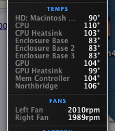

The fan speeds appear normal to me. (I sure hope those temperatures are in Fahrenheit)
Yea the temps are in fahrenheit, thanks for checking them for me. One more question, does reseting the SMC and PRAM reset the fan speeds? OR the fan controller?
It supposedly does, but no guarantees. Seeing as how your fan speeds appear normal, you shouldn't have anything to worry about.

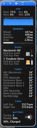

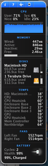

Ok thanks guys...the fans seem to be running well, here is one more screenshot of them under some decent cpu usage...
Does this look ok?
Does this look ok?
EDIT: The degrees are in Celsius now because I thought that might be more universal
I think its fine. The only problem that I've heard of with fan controller after removing it is that it doesn't increase fan speed at ALL.

Ok thanks a bunch, I didn't want to screw up a new MBP

Mine (without fan control) starts ramping up at 160 (F) to about 3000 rpm. It goes to 4000 at 170 and it goes to 5000+ at 180 + degrees. Below 160=2000.
Ok thanks that works great as a comparison for me...and everything looks to be pretty close to that so no worries.
