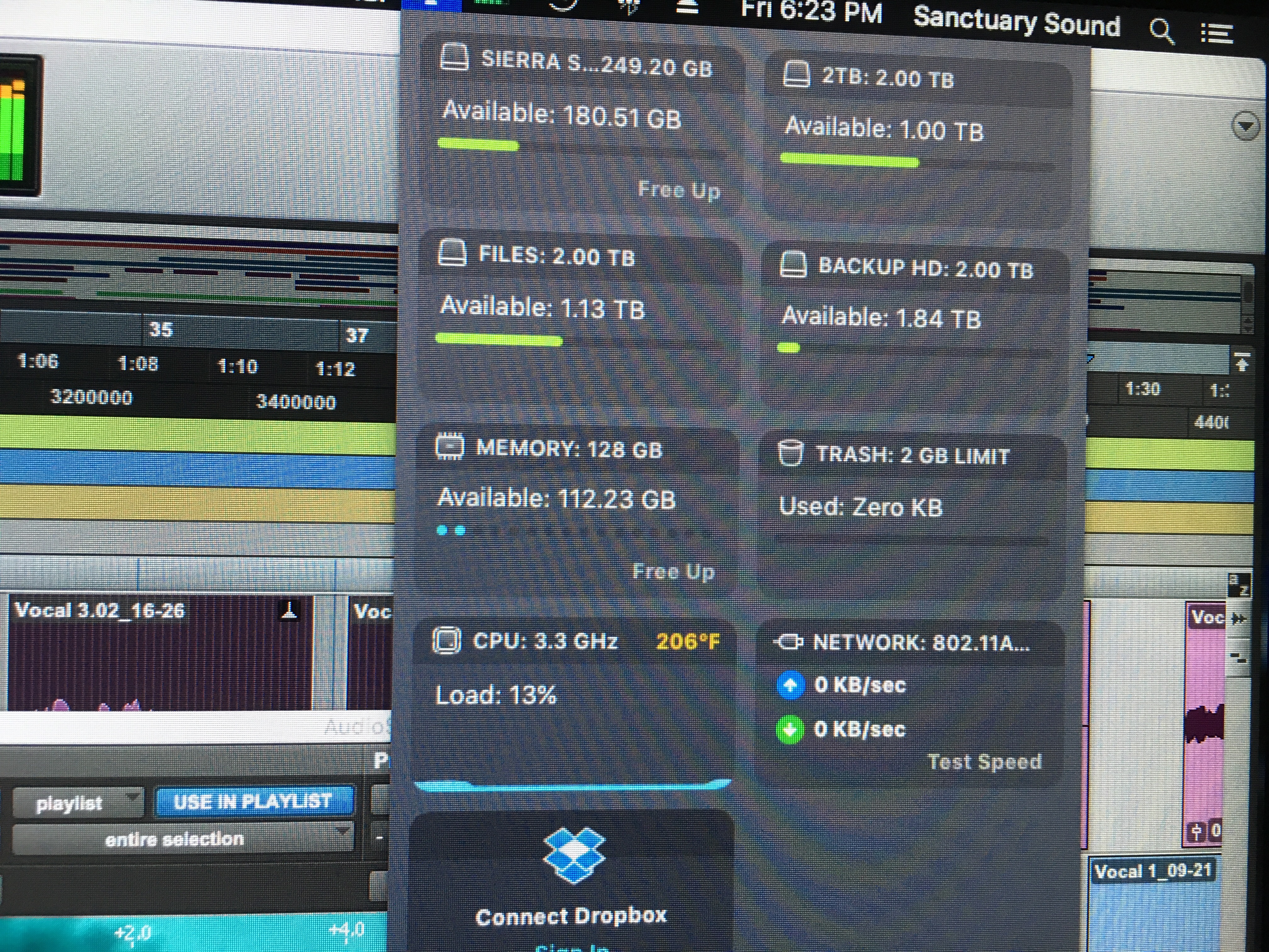

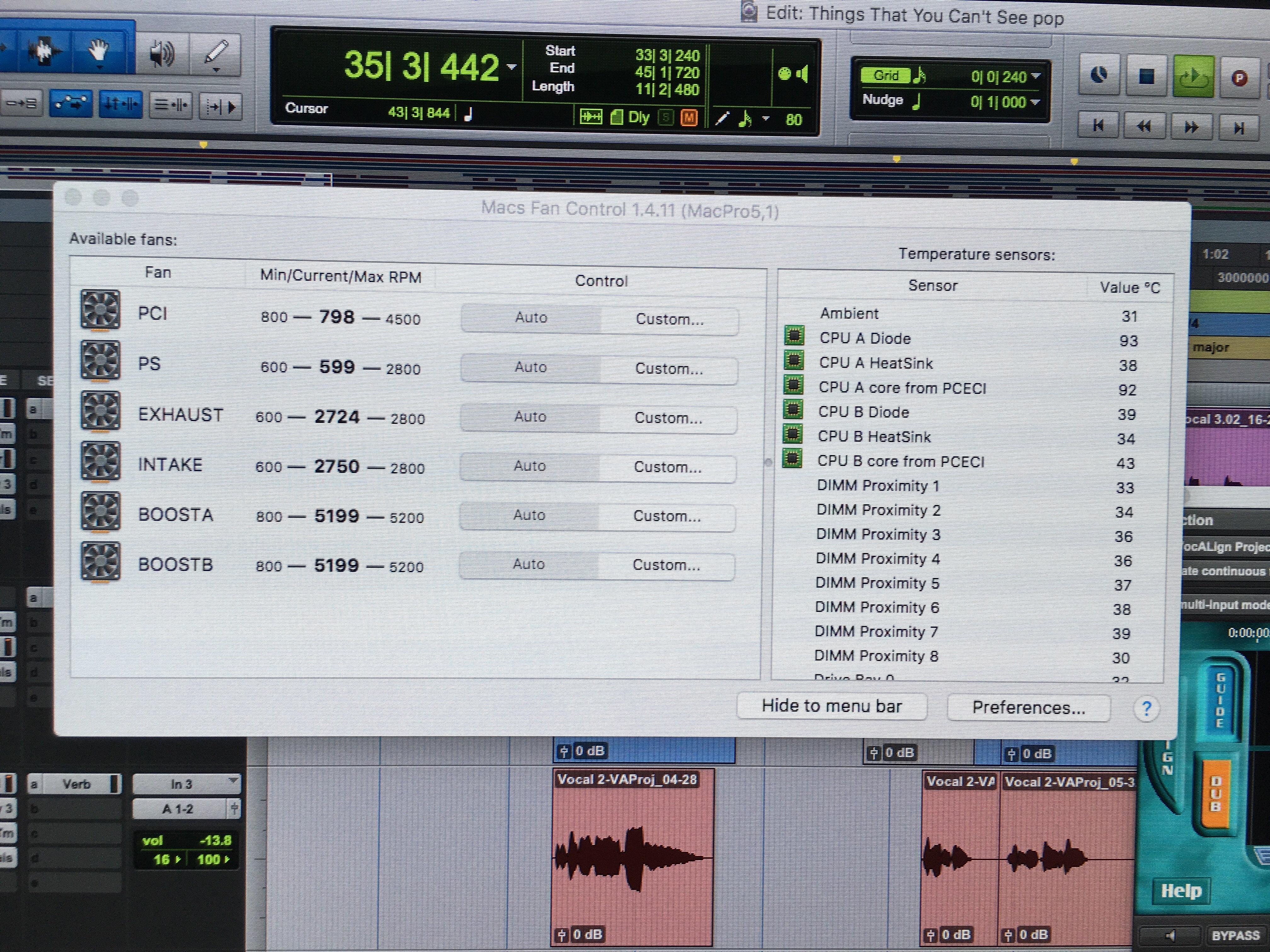

Hello all, and thanks in advance for any help you can offer. I’ve recently upgraded a 2009 4,1 to a flashed 5,1.
Specs are:
128gb 1333mhz ram
Dual X3680 (delidded)
OS: 10.12.6
GPU: Flashed MSI Radeon 7590 3gb
Boot drive: 250gb SATA Samsung 860 evo on PCIe blade
Additional drives: Three 2tb HDDs (one in optical slot, 2 in drive bays), Samsung evo 840 250gb ssd running Mavericks (for the occasional use of legacy software)
My question is this, after the upgrade the system seems to be stable. As in, no random shut offs or reboots. However, with only a minimal load the fans go nuts.
I’m an audio engineer, using Pro Tools 12.5.2. The system was stable with the previous CPU tray (a single quad tray that I upgraded to a single hex), but was maxing out under heavy load. Even then the fans would not soar as high as they do now. Macs Fan control reads 98 degrees Celsius on CPU A with only a 14% load and the fans kick in to overdrive. The heat sink temp is around 60, while CPU B stays extremely low by comparison. Could this be a result of improper thermal compound or improper tightening on the heat sink?
Thanks!

I’m in the early stages of testing after removing the plastic retainer, reapplying thermal paste and reseating the heat sink. So far so good! The same session that was a 14% load and causing 98 degree cpu temps is now operating fine. Fans are spinning very lightly above minimum, and cpu a diode reads around 60 with the heat sink around the same temp. I am in your debt! It makes total sense that your solution worked, and never occurred to me in the original installation process. It never appeared in any of the literature I referenced either. My hat is off to you, thank you!
