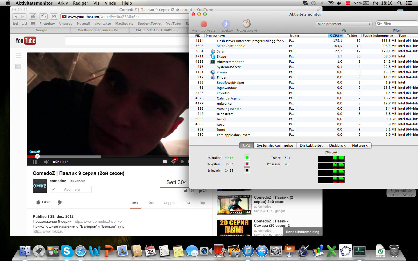

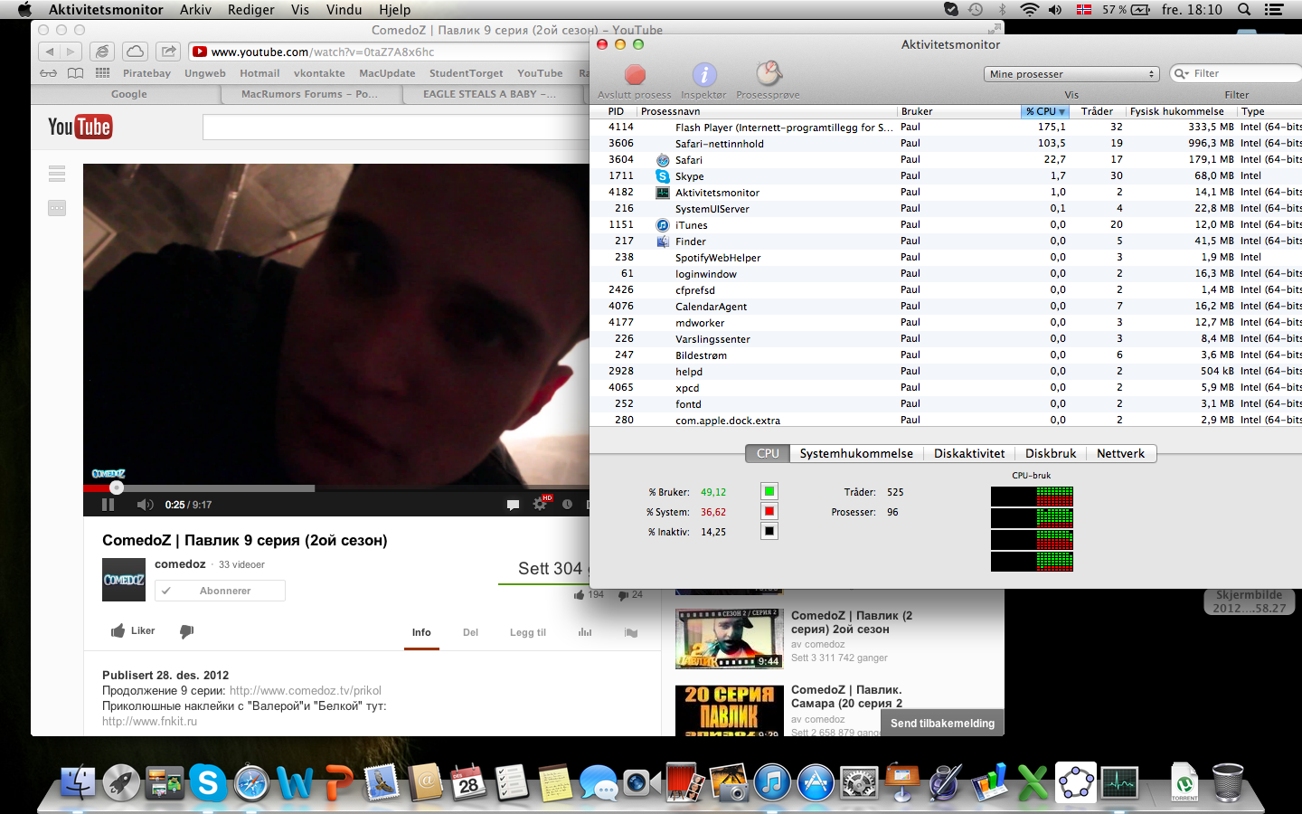

I checked activity monitor for 1080p video on youtube. Whenever I view a video in 1080p the Flash Player is always staying at around 107% of CPU. If i pause the video, the cpu is back to normal. Ive attached some screenshots.
What is the problem? How can I fix it? Im so tired of that noise. I would really appreciate if somebody would help me.

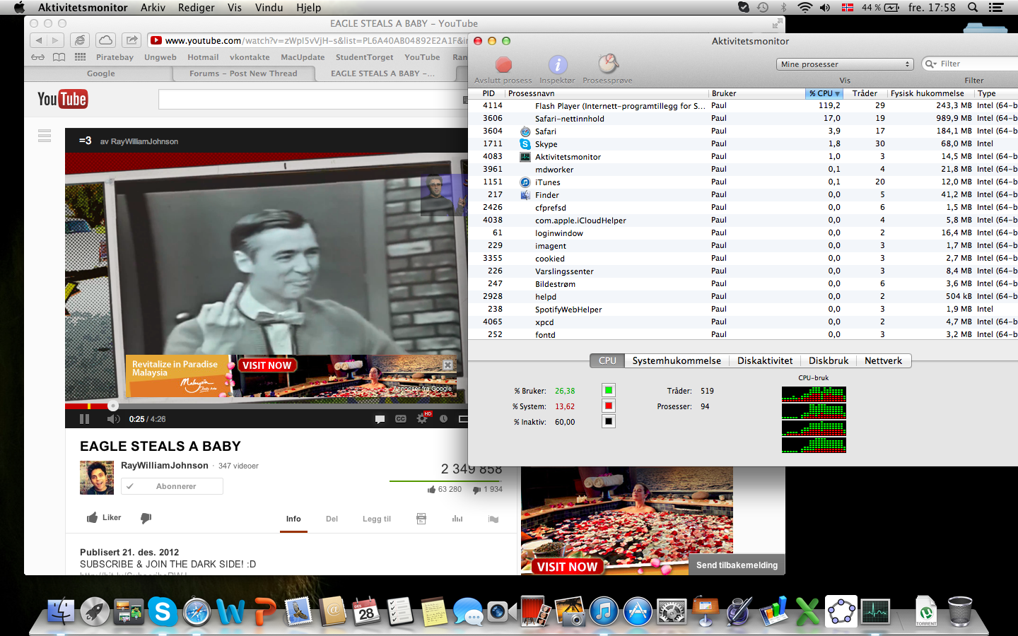

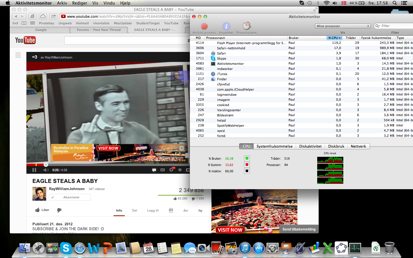

Just ran a test for you to show you the different between using flash and HTML5. The native HTML5 player for youtube can be found here http://www.youtube.com/html5
I still highly suggest that you install clicktoplugin so that anything you may come across can be played in HTML5 even if the website doesn't have a setting for it.
First one is flash playing a 1080p video and the 2nd is HTML5 playing the same 1080 video.
