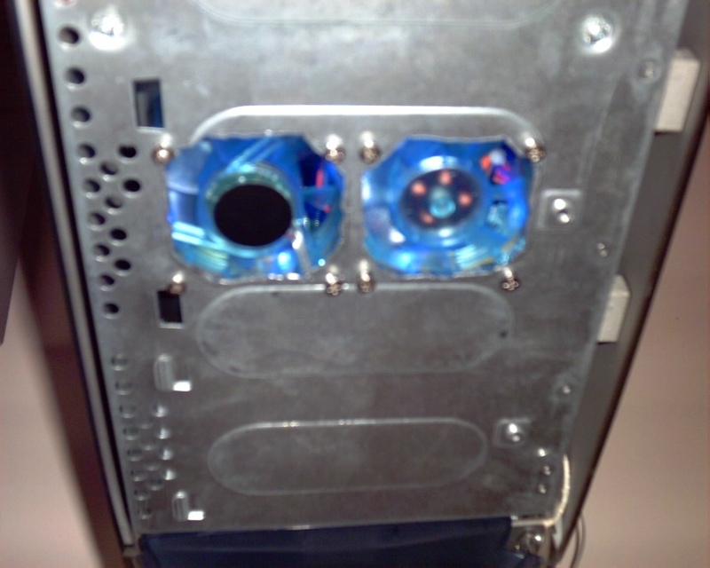

SO! I decided to install some nice lookin fans. This is a first for me, but the process was pretty simple. Cut some holes, make some screw holes, screw in the fans and hook em up.
The fans are a little noisy but aren't a bother really.
attachment.php
attachment.php
I have one fan blowing in and another out. Just how I set it up for now. Anyone know if I should have them all blowing in or all blowing out?
attachment.php
And they give the bottom of the case a nice blue glow. Very neat indeed.
I would think you would want them both blowing out. Or else you're blowing the hot air out, it's trapped under the case area, and then it's sucked right back in by the other fan.
Firstly, may I congratulate you on a very neat job - though I'm not that sure of the blue LED, but I get the impression I'm in the minority there.😛
Hot air rises, so I'd get them both blowing cool air in, but I can't remember if there are any fans/vents near the top of the case sucking the hot air out. Also this does open you up to the risk of sucking a great deal of dust in from the floor/carpet, so ideally I'd keep it off the ground and well-hoovered.
David

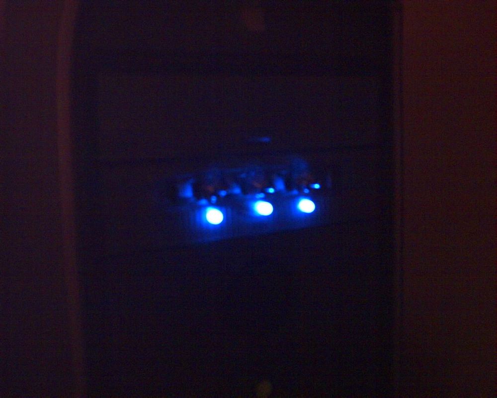

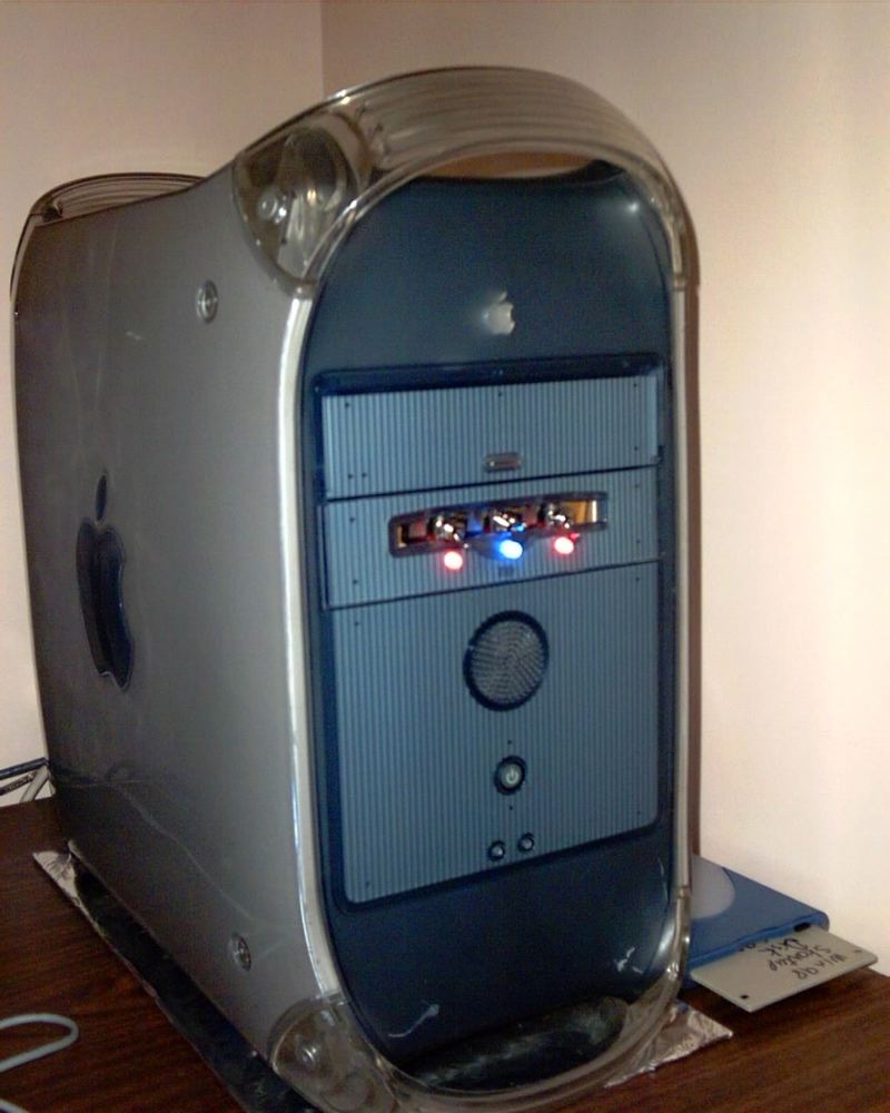

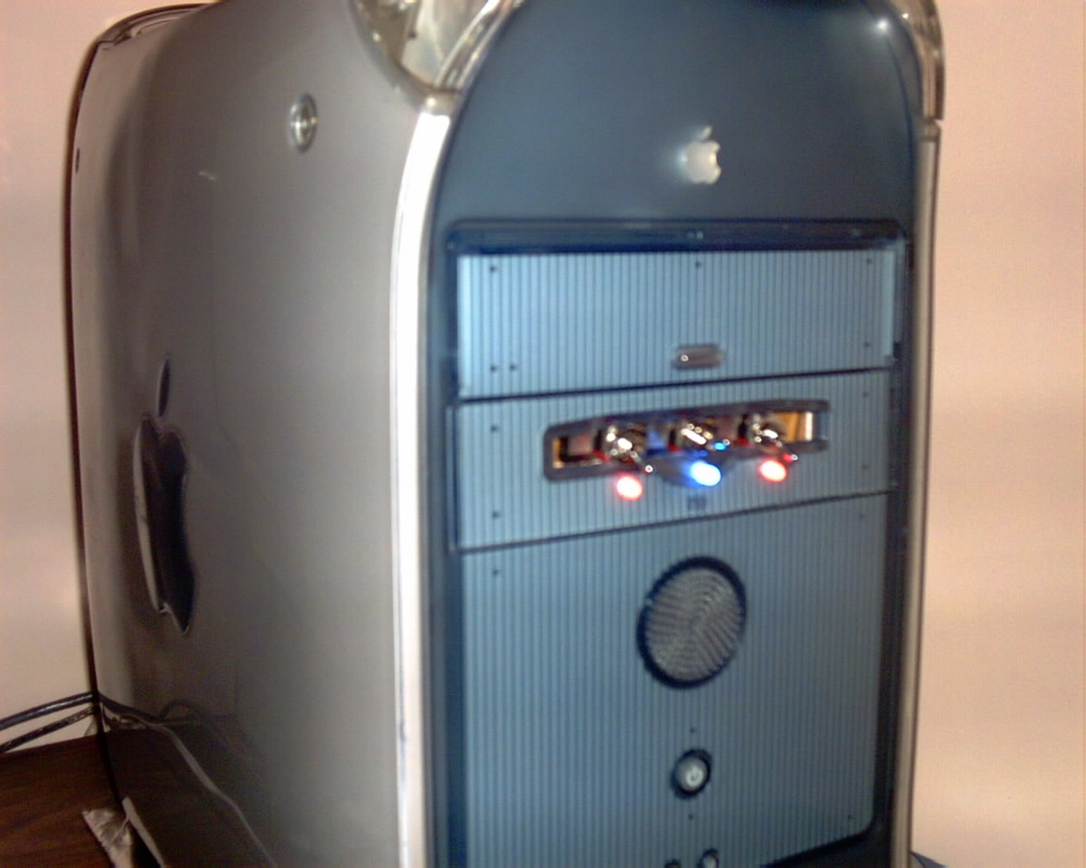

Alright, I finally got a fan controller. Decided to install one due to the loud fans.
Has a setting of fast, slow or off. I keep one fan on fast and the other on slow. Greatly decreases the noise.
Installation was easy. Took about 45 minutes. Fits perfectly in the empty ZIP drive.
I'll probably make a nice guide on how to install fans and a fan controller for a G4 tower later when I get a nicer camera. Not that anyone else would wanna do this but would be a good reference. 😉
