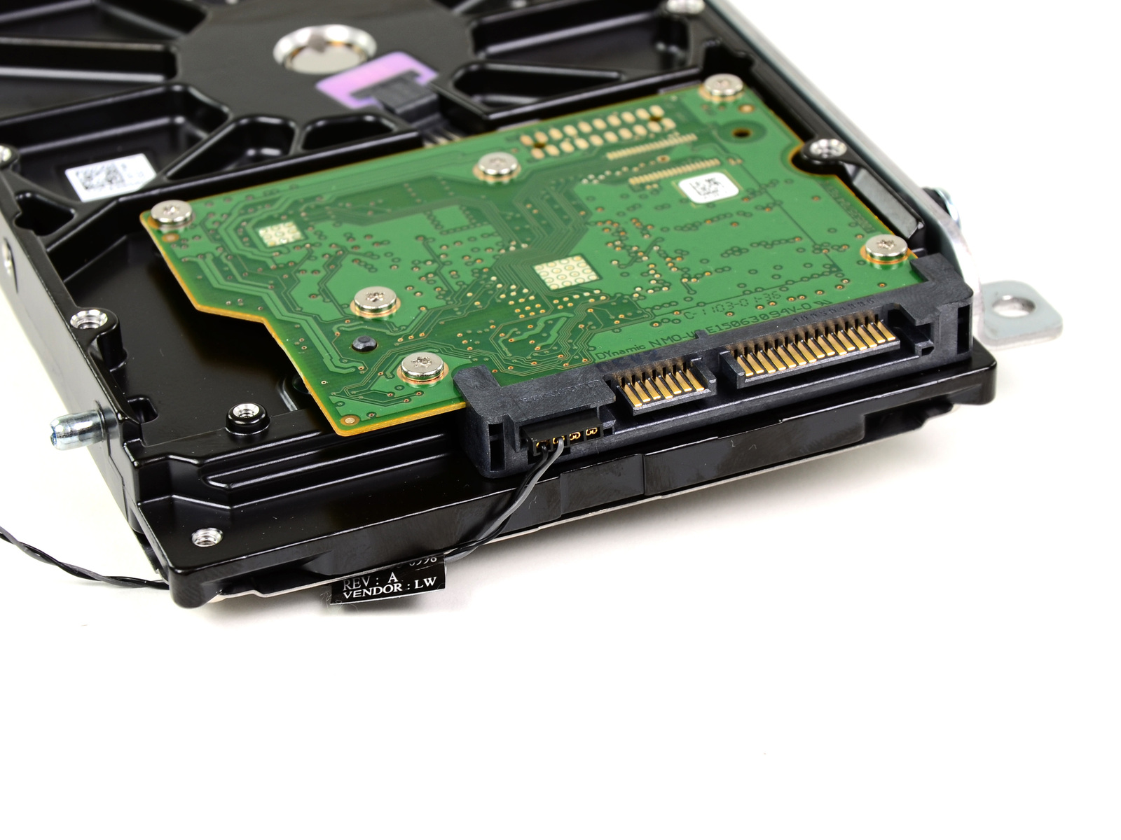

I have installed new HDD in it and when I start iMac everything is fine for a few minutes but then fan start to become noisy and noisy and noisy...

Is this that temperature sensor (Middle slot)?

The iFixit Guide for Late 2009 21.5 iMac, EMC 2308
http://tinyurl.com/lfekxvt
Steps 8 & 10 address your problem.
"Before disconnecting the thermal sensor cable, take note of its orientation. It is extremely important to reinstall the connector reversed from the current orientation so the fans will not run at full speed."

On step 8 I see that man remove that cable from motherboard.
I shouldn't touch that right?
On step 10 what is meant by "reverse the connector's position"?
Should I pull (that man hold by hand) that cable out of HDD and turn it around and back in?

You have to remove it because there isn't enough slack to remove the drive, otherwise you risk breaking the cables, or the connector. Check the orientation of the connector in reference to the socket to make sure that you plug it back in the proper way.

I ended up having the same drive model for the one that I replaced and plugged the cable in the same orientation. It worked.
