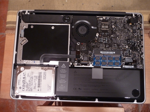

I have the 15". The back cover looks like that when opened. The picture is not mine, so the remaining plate is removed there for whatever reason.
I don't see the fans anywhere in the back panel. Am I missing something. I'm a newbie when it comes to the actual hardware of a computer/laptop.

It's in the middle of the picture! See that plastic thing with little blades next to the optical drive. That's your fan. That looks like a 15" base model. If it has dual graphics, there'd be two of them.

Is the picture of 15"? My MBP 15" has two fans. A middle one and left one.

That's the 13" model.

I took off the bottom part.
Someone please point to me where my fan is LOL.
I'm sorry, but if that was a serious request, you shouldn't be disassembling anything. The fan is under the panel that you haven't taken off yet.
Correction: according to the pic, it's the top middle.
