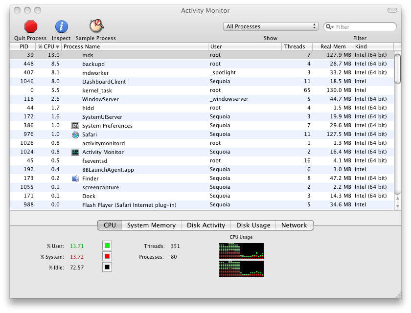

Have a look at Activity Monitor ( Applications / Utilities / *) and select All Processes*and sort by CPU to see what the culprit may be, as the fan just doesn't spin that high without the CPU being hot.
image below uses sorting by CPU as an example
Alright, I did what you guys said and RIGHT NOW the fan is running because I'm doing a time machine backup, but before it was running for no reason. So, I guess I'm going to do a clean install of SL maybe that'll help the fan from running so fast. I also did a hard reboot on my computer, that stopped the fan from running fast for about 30mins then it started up again. I then did a SMC reset; as you can see that didn't help either. Oh yea, I don't know I put a pic up but I already have SMC Fan Control. Downloaded that as soon as I got my laptop. I have no idea what MDS is 😕

A clean installation will probably not fix the issue, as "mds" is responsible for indexing the HDD/SSD, to have fast search results in Spotlight. Sometimes the process runs a bit havoc. If the "problem" stays for the next day or two, you might try a Clean Install of OS X 10.6 Snow Leopard, or just use System Preferences > Spotlight > Privacy to exclude some folders from Spotlight. Often high activity folders (ones that are constantly written to) create such high "mds" activity.

Ignore mds - whatever was causing the "problem" finished a minute or two ago. The CPU graph shows that the CPU was running at near 100% usage and that ended a short time ago.
When you took the grab, usage was minimal. Of course, heat takes time to dissipate.
Keep the Activity Monitor open. Whenever the fans start speeding up, check what is using the CPU at exactly that time.
However note that the fans speeding up is completely normal to cope with higher temperatures, and higher temperatures are completely normal with higher CPU use, which in turn may be completely normal for whatever you are doing with the computer.
