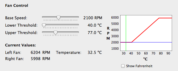

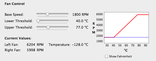

Past few months, fan speed almost continuously @ 6000 rpm, CPU usage completely normal.

- Controlling speed with multiple applications (e.g. Fan Control)

The temperature sensor on your motherboard has malfunctioned, so your computer thinks it's overheating all the time and therefore the fans are spinning at 6000 rpm.
The CPU heatsink has a separate sensor on it, so it's possible you might just have one sensor broken on the heatsink therefore you do not need a new motherboard, just a new heatsink (or sensor if you purchase just that).
