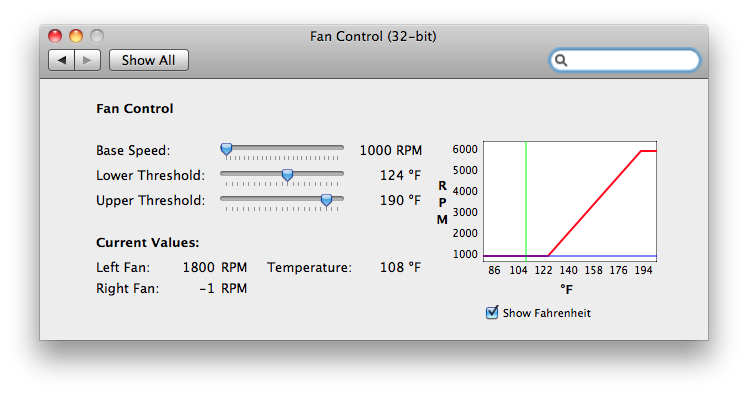

  16. indg thread starter macrumors 6502
    Joined:
    Feb 7, 2007
    #16
    just a quick update. i was able to get the mini's fans going over 1800 rpm (gotta love adobe flash). managed to peak the CPU temp around 180F (82C) and the fan around 2200-2400 rpm. the minimum threshold for the cpu temp seems to be around 170F before the fan speed starts to increase. that's quite a bit hotter than i'd like things to be, especially since the top of the mini's case is fairly hot by that point. if the case is getting hot, that tells me that heat isn't being dissipated out the vent fast enough.
    so i've decided to run Fan Control 1.2 which allows me to adjust the rate at which the fan speed increases. i prefer fan control 1.2 over smcfancontrol because it adjusts the fan speed automatically (background daemon) based on your min/max threshold. just set it and forget it.
    so with Fan Control 1.2 running, i can be doing some intensive cpu tasks (playing 1080p on youtube, encoding h264 videos, gaming, etc.), and the cpu temp rarely goes above 160F because the fan spins up much faster now. meanwhile, the top of the case stays relatively cool since more hot air is getting blown out the back. the fan is now doing what it should have be doing... cooling the internal components when things get hot!

  24. mrfoof82 macrumors 6502a
    Joined:
    May 26, 2010
    Location:
    Lawton, OK
    #24
    Set these parameters with Fan Control:
    Base Speed: 2300rpm
    Lower Threshold: 131F (55C)
    Upper Threshold: 158F (70C)
    The result is the fan will end up running around 2400-2430RPM. At idle the Mini will mostly be at 120F (49C). Under full CPU load (i.e. video encoding for 6 hours straight) the fan usually kicks up to around 4000-4200RPM, keeping the CPU more around 140-150F (60-65C), with ambient temps closer to 100F (38C).
    This is with a 2.66GHz, not the 2.4 (though they have the same TDP). It's running quite cool, and is still inaudible at 3 feet.
