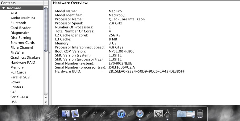

My new MacPro is less then a few weeks old. straight out of the box the fan in between the DVD drive and the power supply goes rather loud after 20 seconds of the machine powering on, and stays loud. Iv'e reset the SMS and still no change, recently updated the 10.6.5 and again, no change.
any thoughts on what might be causing this? no programs are running that would need such a high fan speed, the machine does this of its own accord.
thanks for your help!

I've heard of the SATA cable on the optical drive rubbing up against the psu fan/enclosure. You may pop the optical bays out and try flexing or repositioning the cables a little and see if it improves. If it's still making fan noise and you are sure they aren't touching you might drop it by an apple store for further evaluation.
It's likely that a temperature sensor in the PSU is unplugged or malfunctioning also. They usually default to a failsafe full-on mode if that happens to protect hardware.
