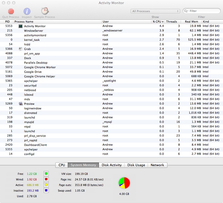

You may have more running than you realize. Follow every step of the following instructions precisely. Do not skip any steps.
  1. Launch Activity Monitor
  2. Change "My Processes" at the top to "All Processes"
  3. Click on the "% CPU" column heading once or twice, so the arrow points downward (highest values on top).
    (If that column isn't visible, right-click on the column headings and check it, NOT "CPU Time")
  4. Click on the System Memory tab at the bottom.
  5. Take a screen shot of the entire Activity Monitor window, then scroll down to see the rest of the list, take another screen shot
  6. Post your screenshots.

Thanks for the help. I think the SMC reset has fixed this, though it may take a bit more usage before I'm fully confident of this. It definitely was running too hard for what I've been doing.
Regardless though, here's a screenshot of my activity monitor:
attachment.php
Sorry I haven't got a screen shot of what's lower, but I think this is enough to get the idea of it. It's all pretty lightweight stuff, I supposed I had a bit of wired RAM, but I don't think that should cause the fans to need to spin up hard.
