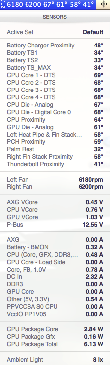

after reapplying thermal paste using Artic MX-4 in my Late 2011 MBP 15'', I have excellent results specially under heavy load tasks, such as CAD or gaming (All under Mac OSX).
This is a screenshot of temperatures after 1 hour of gameplay with F1 2012 on an external display (the internal display is off, as I use the MBP in clamshell mode with open lid https://www.youtube.com/watch?v=j3CCAanNhiA )
The problem is that even if the temperatures are good, I have the fans spinning all the time at max RPM.
Do you think that is a bad thing to left the fans for 1-2 hours at top speed?

I've done the AHT after your suggestion, but all is right. Anyway, in all the other situations the MBP fans works correctly (they gain speed not very often) , and also when I quit the game, the fans spin at 2000 rpm after 2minutes.

Yesterday I tried to place a fan under my DIY aluminum support and the situation is much improved: in 2 hours of play, the fans never arrived at 6200 rpm, because the temperature were even lower.
Since the external fan is effective but too noisy, I will try with a Peltier cell (I will receive next Tuesday).
It seems to me that the way of operation of the fans is as follows: when they arrive at the maximum RPM due to temperature, they keep it until the temperature drops down to 55-50 degrees Celsius. So if during the game the temperature remains around 70 degrees (which is already very good) the speed of the fans does not drop even though it might do so.
