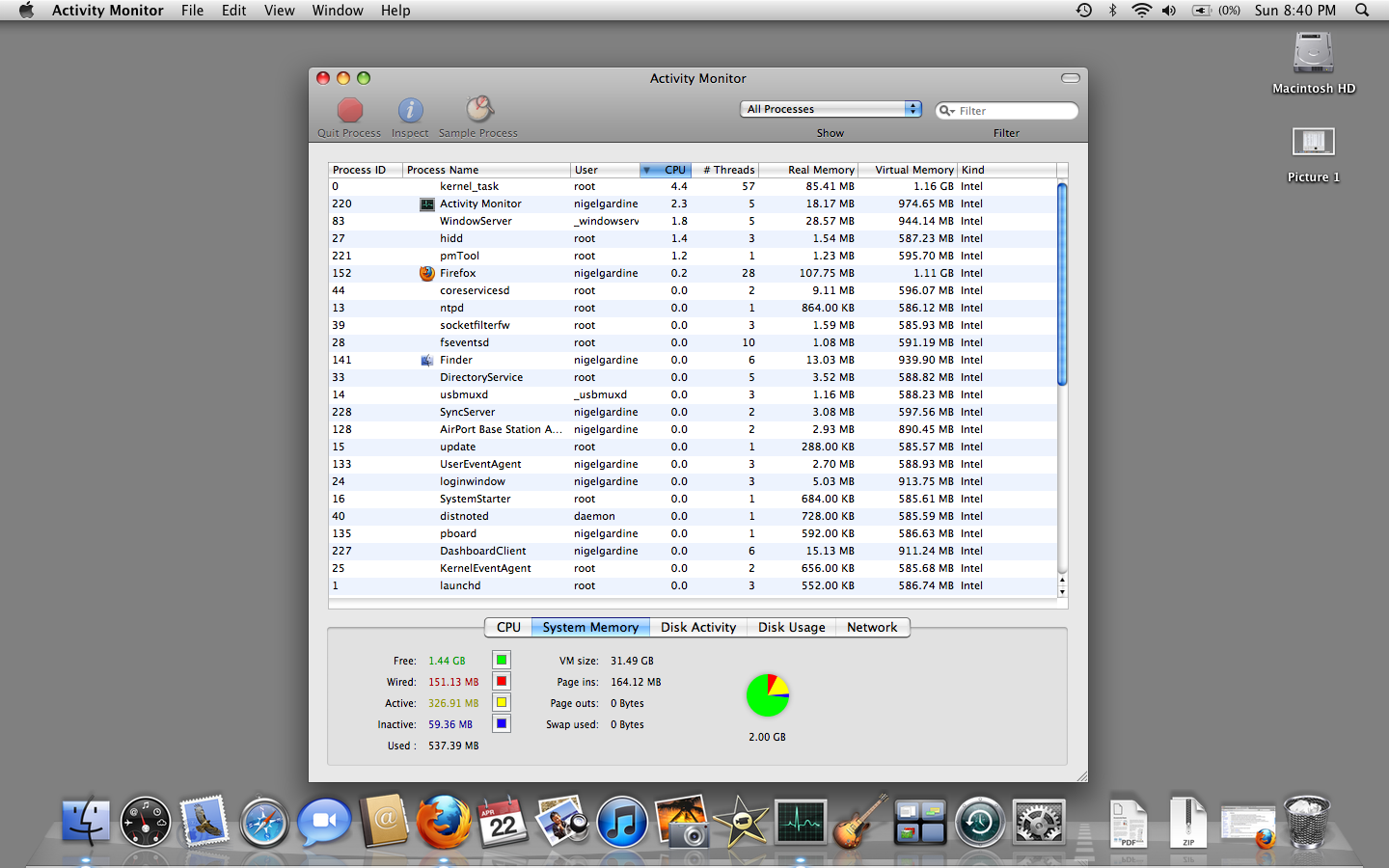

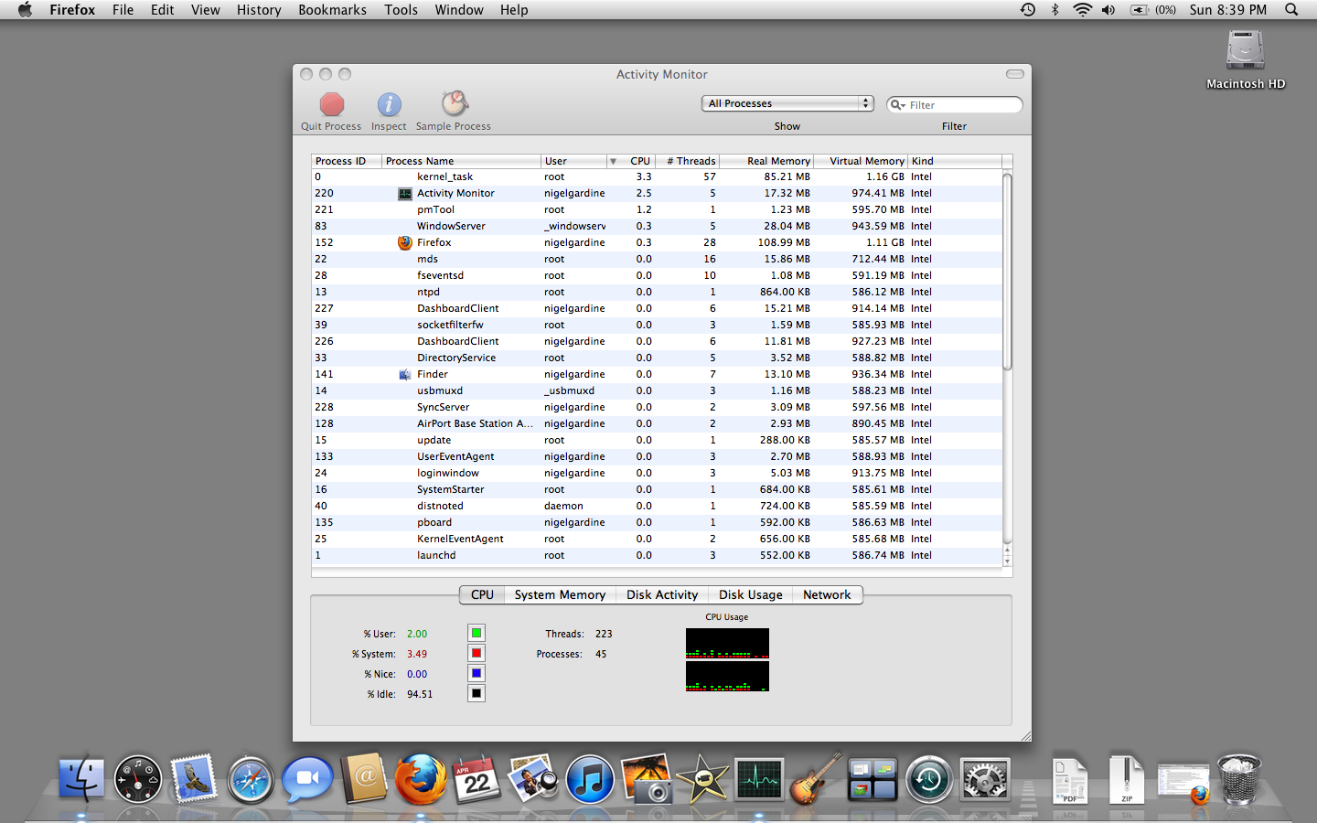

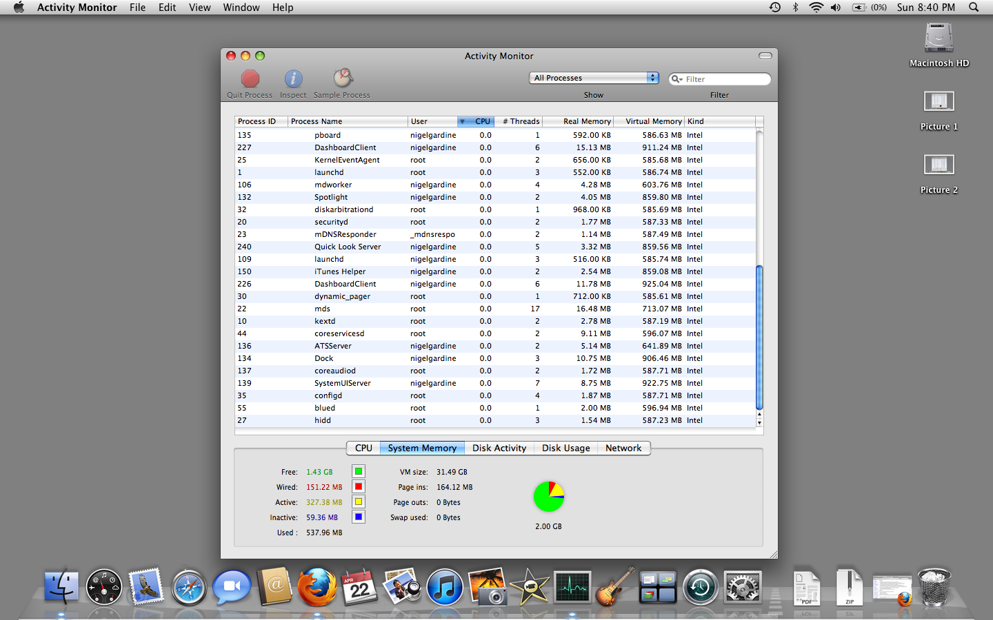

Launch Activity Monitor and change "My Processes" at the top to "All Processes", then click on the CPU column heading once or twice, so the arrow points downward (highest values on top). Also, click on the System Memory tab at the bottom. Then take a screen shot, scroll down to see the rest of the list, take another screen shot and post them.
thanks, don't have that machine with me right now but i'll post those up this evening.
I did look at the activity monitor and there was nothing using up cpu time drastically.
Hi here are the screen grabs.

It sounds like you may have some hardware issues. Since resetting the SMC didn't correct the fan issue, and there's nothing in Activity Monitor indicating high demands on your system, combined with the other issues you mentioned, a hardware problem appears to be indicated. Take it to Apple and they can diagnose the problem and tell you what, if anything, it will cost to fix it. It may be a loose connection or something else simple that they might fix at no charge.
