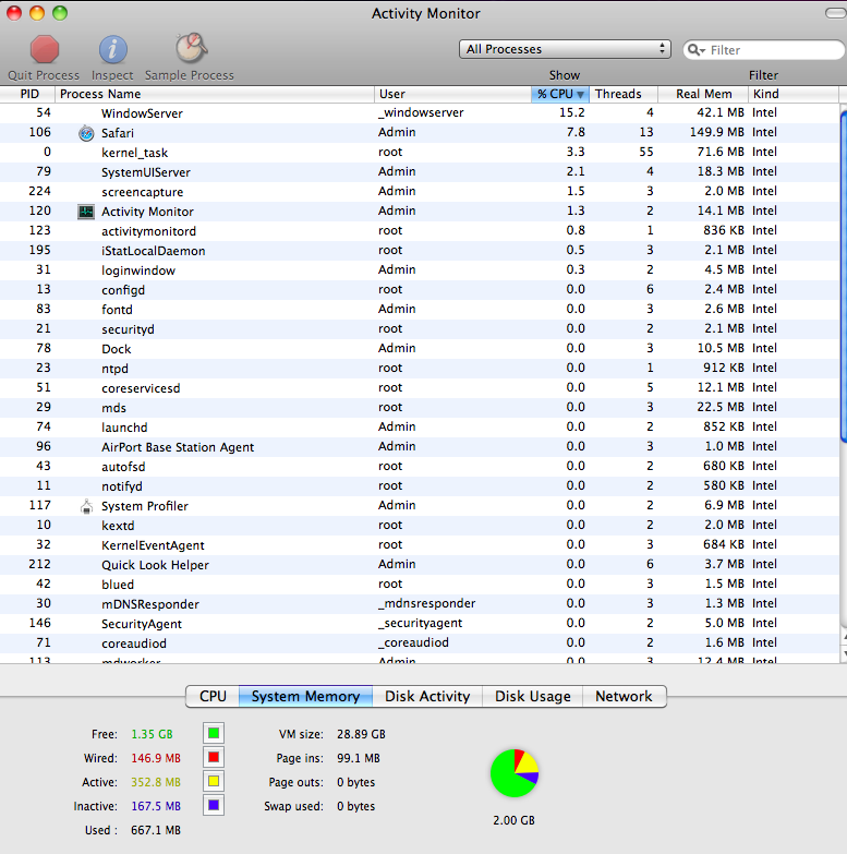

Install iStat Pro to get accurate readings of your temps. Resetting the SMC will help if the fans are spinning without increased heat. If you do have increased heat:
  1. Launch Activity Monitor
  2. Change "My Processes" at the top to "All Processes"
  3. Click on the CPU column heading once or twice, so the arrow points downward (highest values on top).
  4. Click on the System Memory tab at the bottom.
  5. Take a screen shot of the whole Activity Monitor window, then scroll down to see the rest of the list, take another screen shot
  6. Post your screenshots.

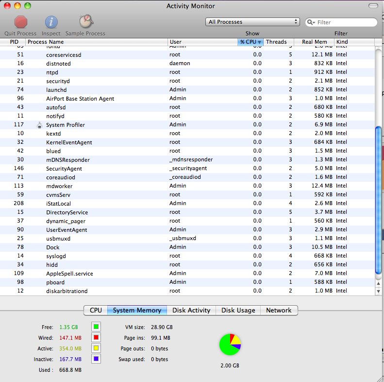

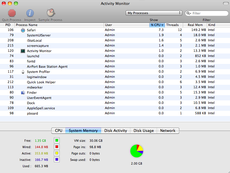

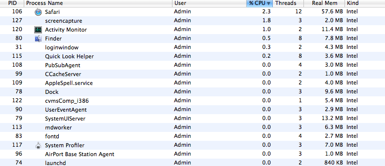

I've attached a screenshot. This is a clean install of snow leopard and the fan problem starts at boot, so I don't believe it is an issue with some program sucking up resources.
That being said- I'm out of ideas. I looked up the procedure for temp sensor replacement and its quite labour intensive. Is there any way to tell if the sensors are damaged or defective?

Please re-read the instructions and post the entire Activity Monitor windows, as important information is missing.

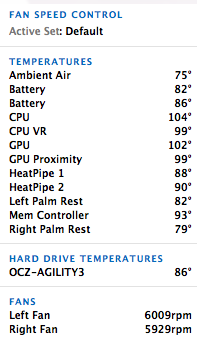

Thanks, that's better. I don't see anything there that would prompt high temps. Did you install iStat Pro? If so, can you take a screen shot of that, so we can see your temps?
Attached. These temperatures are consistent from the moment the computer boots and generally don't move around much.
Your temps are quite normal. I would disable SMC fan control, then do another SMC reset. If that doesn't help, it's likely you have a faulty fan sensor.
