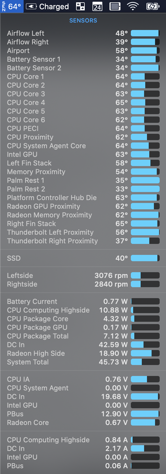

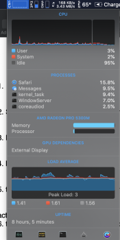

I just got the 16" base connected it to the 21.5" 4K LG UltraFine monitor via USB-C. someone on here told me ho fan issues on their end with this setup but this is what I see on my end. Seems the Video card is maxing out. Is this within normal? I'm watching Netflix on 16" and a document on the 21"
It looks like just the VRAM (frame buffer) on the GPU is maxed out - the video card isn’t actually processing much. Your fans are spinning pretty fast there, but your CPU temps are quite low.
I do not have a 16” machine, but based on what I’ve read, Apple made the choice with the 16” to be more aggressive with the fan curves to keep thermals in check. While in the past 15” models they favored higher CPU temps and silent operation. What you have mentioned above I do quite often on my 2017 15” Pro and I do not hear the fans, but my CPU temps are about 10C higher.
