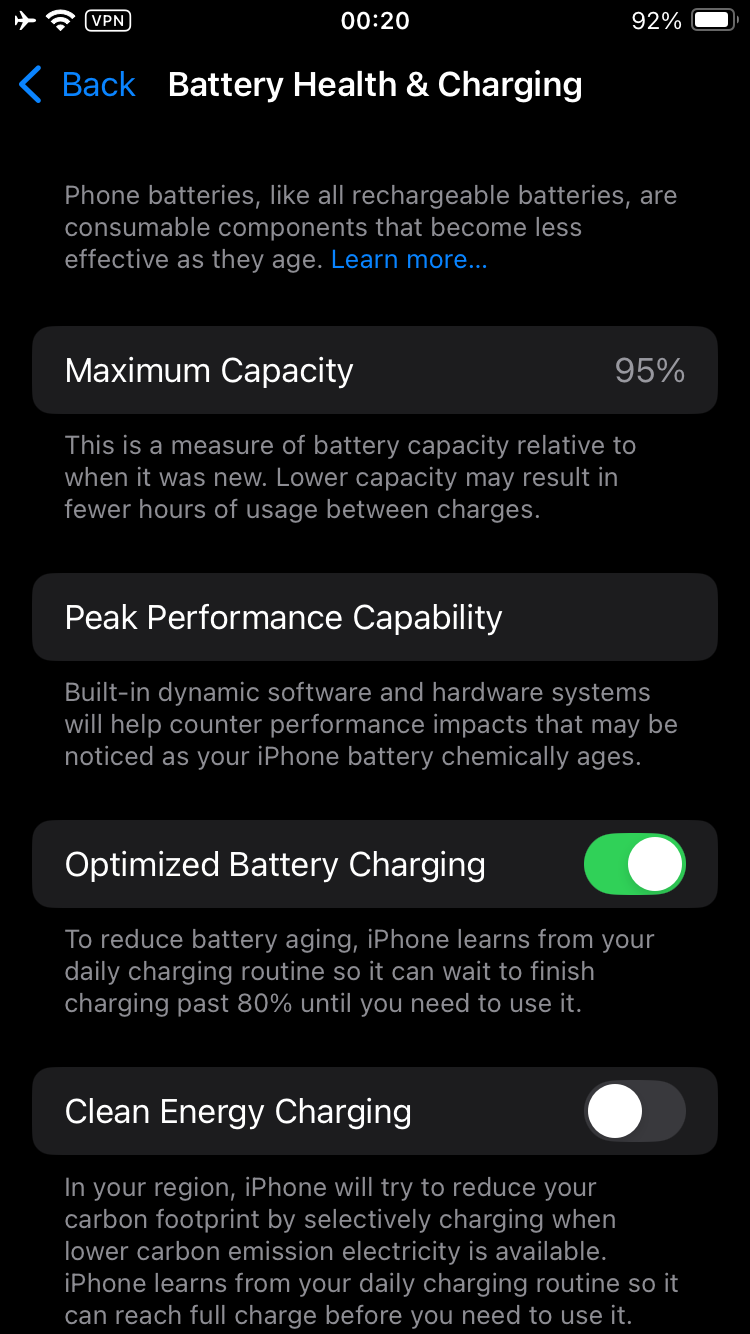

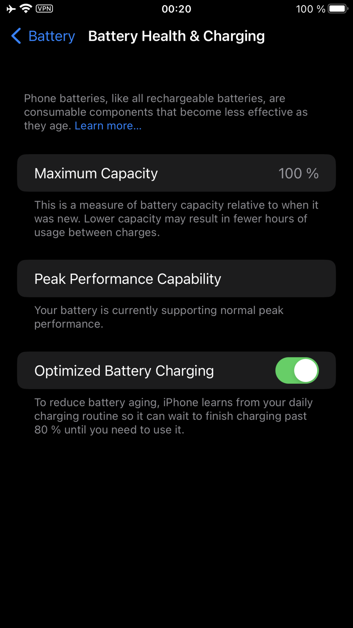

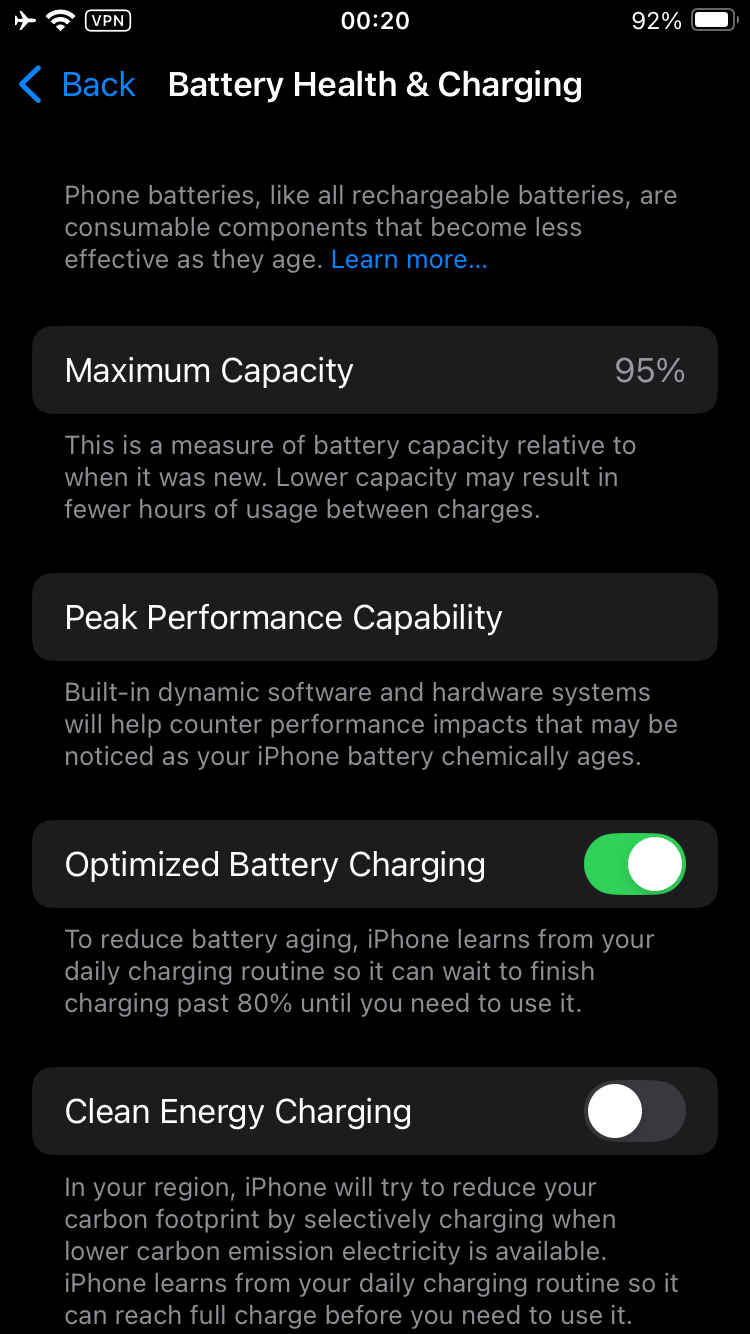

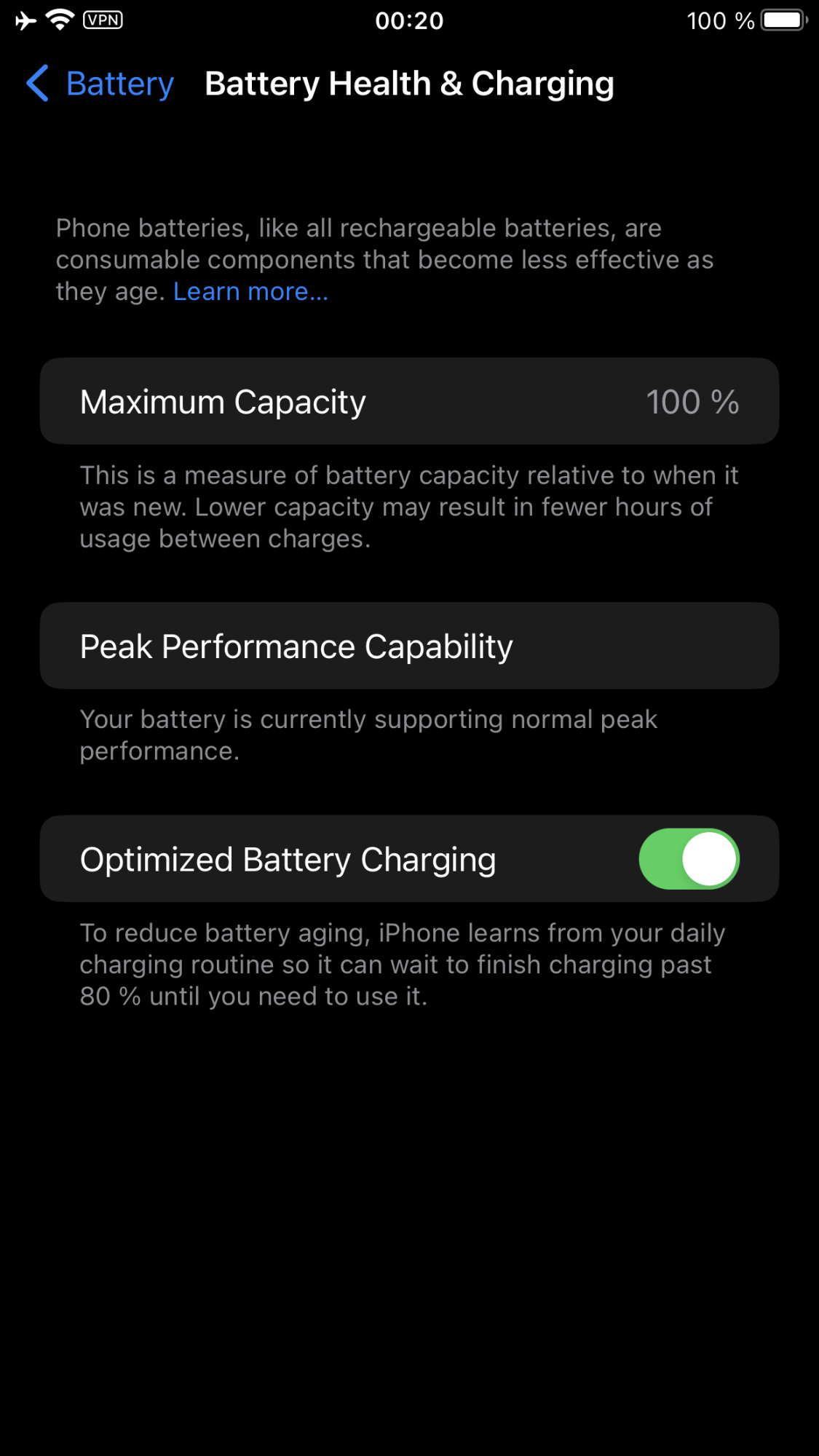

Both were turned off about 14 hours ago with 100% charge. The 8 Plus didn't lose anything the SE3 dropped down to 92%. A few days later both will be completely empty I tested it several times now.
The Maximum Capacity looks very good for both devices. Can 3rd-party batteries fake the Battery Health that is displayed?

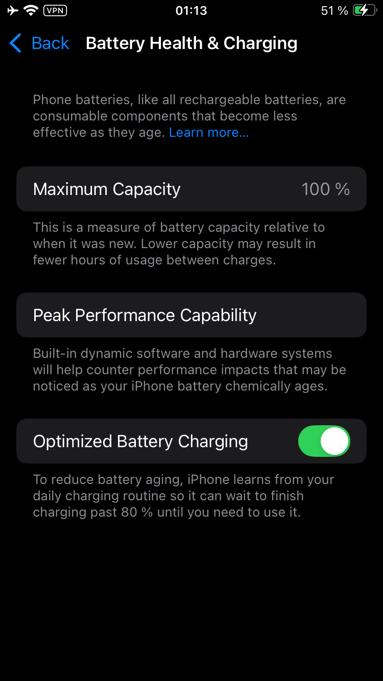

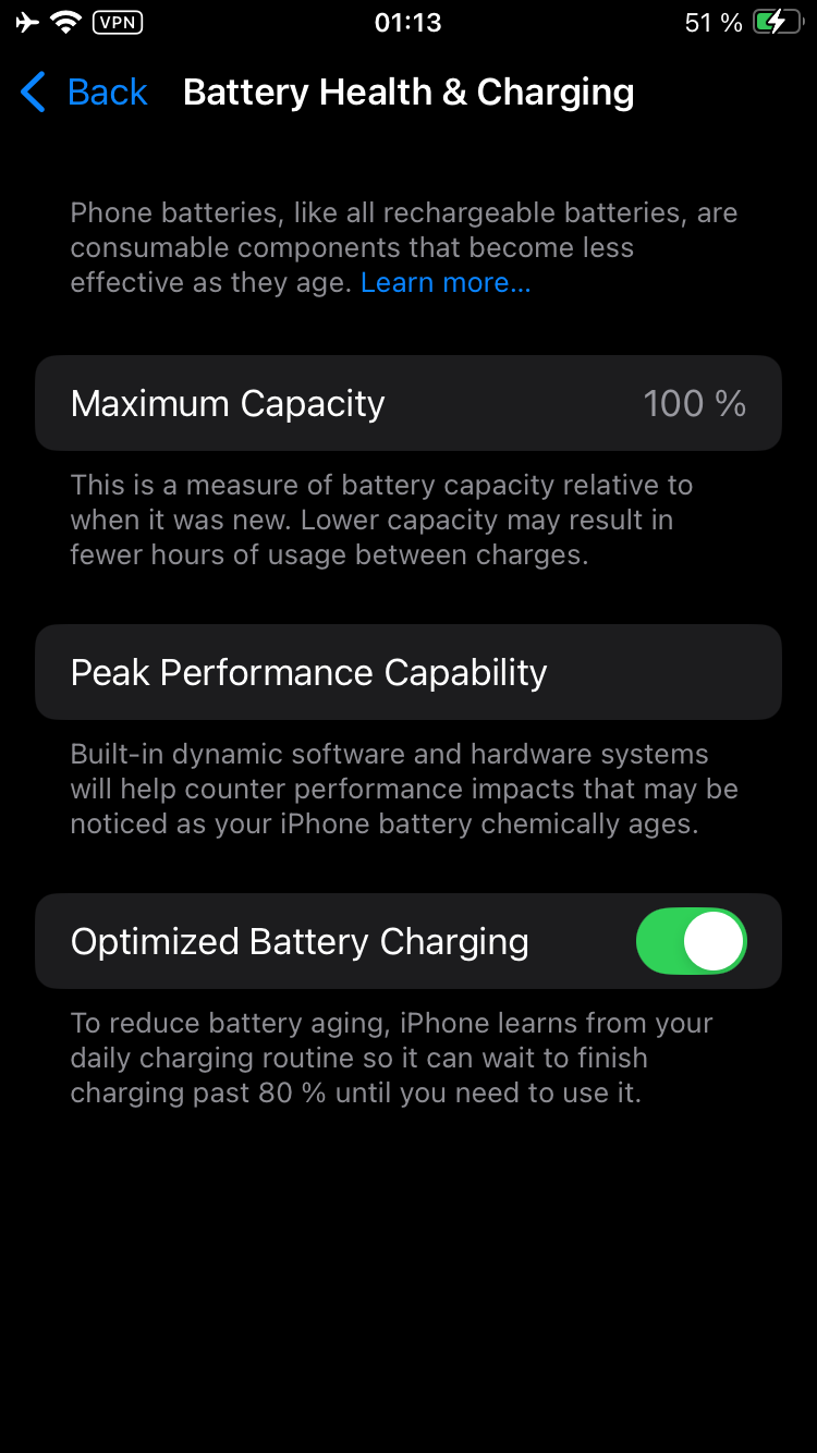

45 minutes later the SE3 is already down to 90% and I did nothing with it, the 8 Plus still at 100% and I used it the whole time, because the screenshot didn't sync until I changed the VPN location.
Edit: The drop from 92 to 90 happened while using it to do the screenshot and sync it. After that it stayed at 90%.
I will now connect them to my Mac to see what coconutBattery is showing.
8 Plus:
SE3:

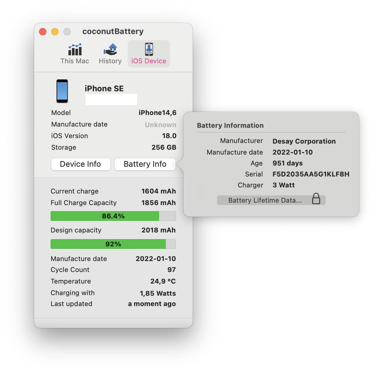

I connected both to the same port on my Mac and one is showing 3W and the other on 13W, strange.

They have both a 12 month warranty. Maybe I'll send them just back. I Have good experience with this website, just got my money back two times and one of them was even a few days over the 30 days return window. Strangly I only had problems with iPhones there, the iPads are all good.

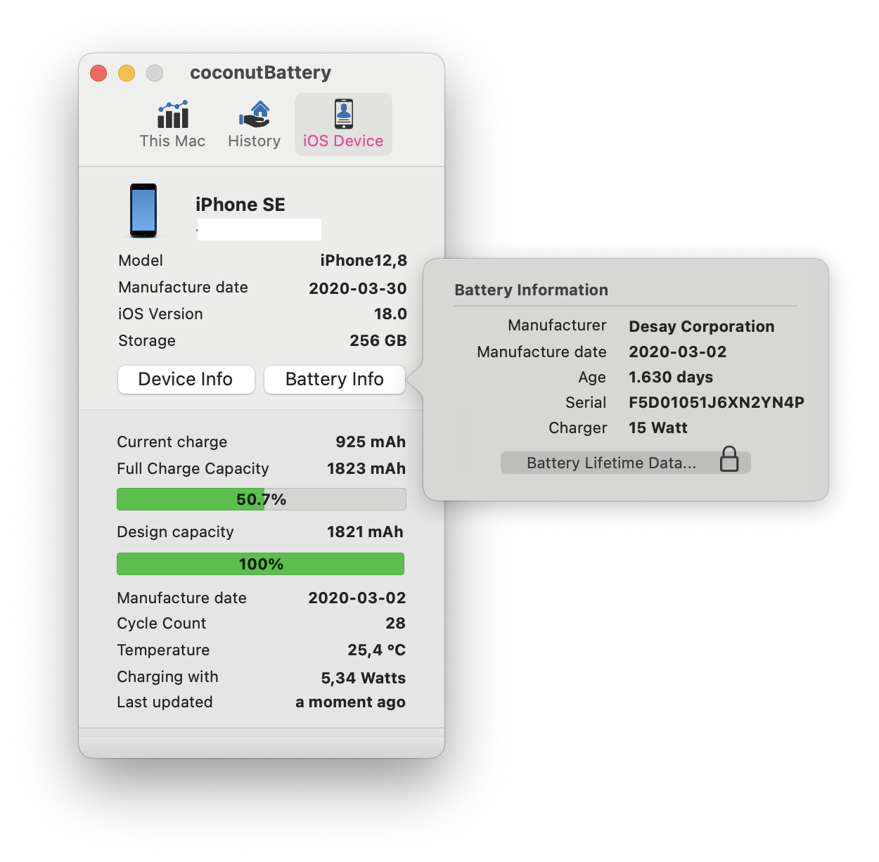

I just tested also the SE2. It has the same manufacturer for the battery and it's much older, but has not those discharging problems when turned off. Also looks like the Battery hasn't been charged before bought it, because of the low cycle count.
