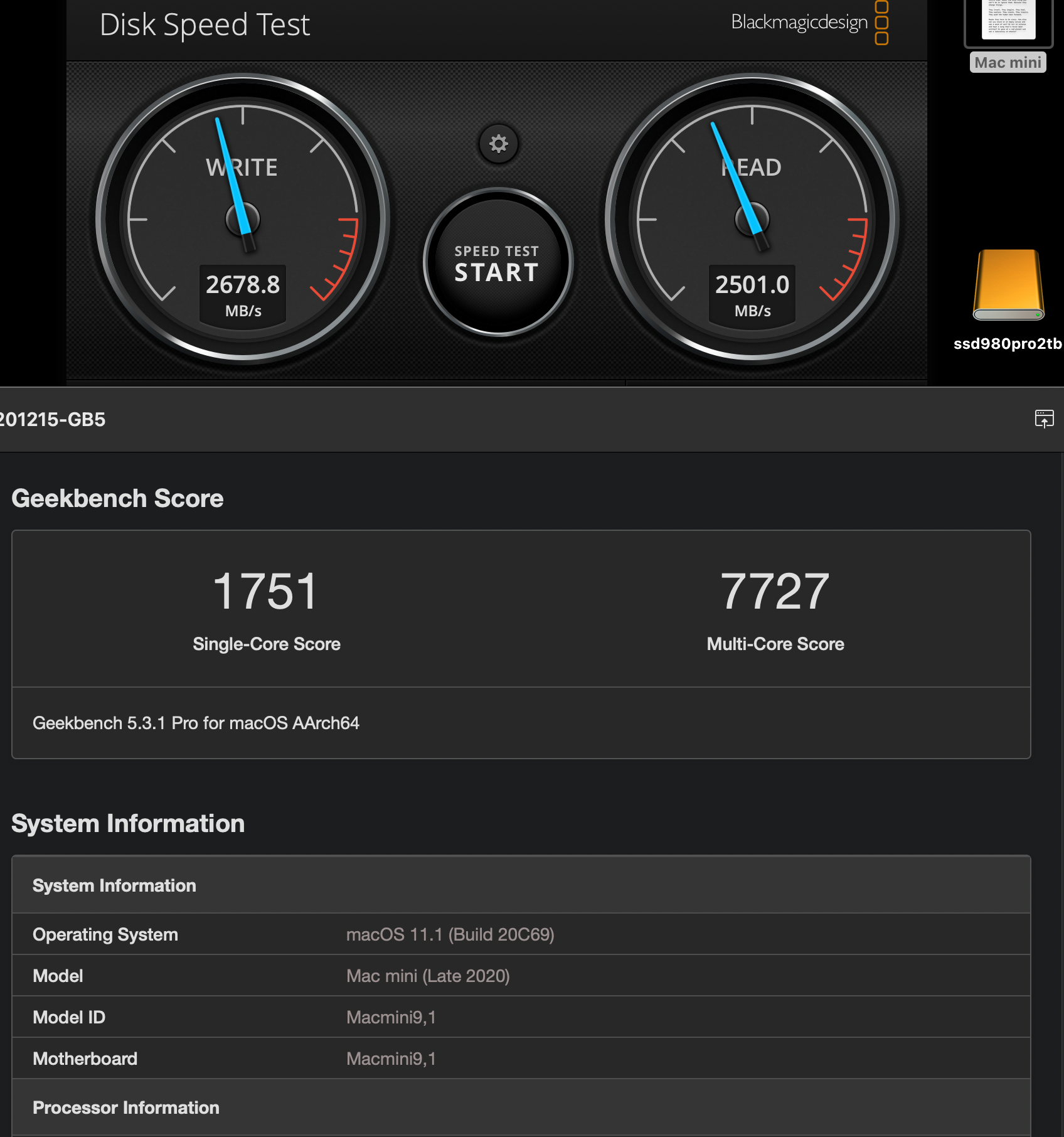

I don't know how fast it can get - but today I got the new Samsung SSD 980 Pro 2TB (PCI-E 4, nvme).
Inside a no-name Thunderbolt 3 enclosure it is nearly as fast as the interal SSD:
Reactions: Quackers
Very interesting. Where did you get the enclosure from? You say it's a no-name, but can you provide any information about the enclosure?
Was it directly connected to your Mac mini or through a thunderbolt hub/dock? Those are some impressive speeds (although they should be for the cost of that drive 😳).
