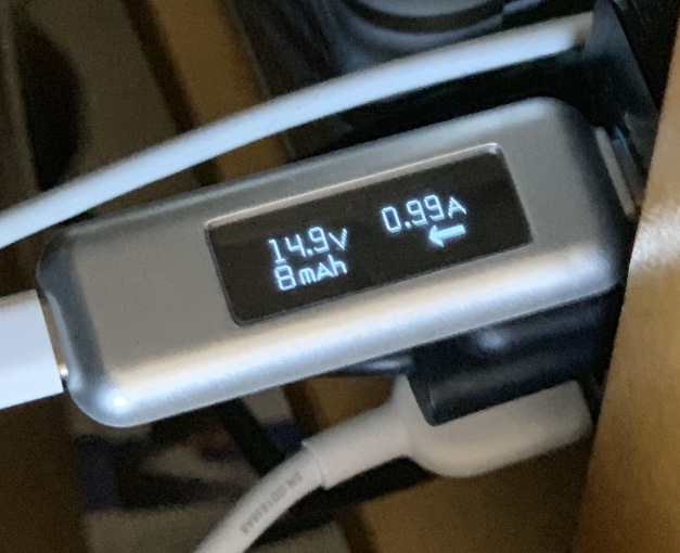

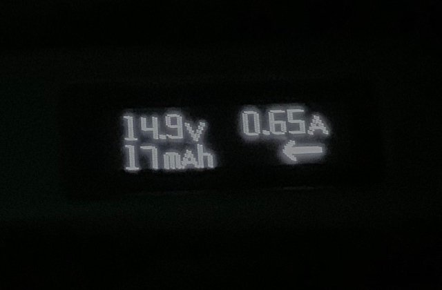

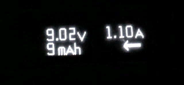

That’s what I get from the SmartBattery Case for the XS with a X inside at 68%
That’s from the XS Max at 73%
Each one is picking its prefered voltage. Same USB-C Lightning cable and same Anker PowerPort 5+ USB-C.
Interesting, so the iPhones can charge at even 15 Volts. But I notice that its charging at around 9-10 Watts even though its a fast charger. Is it maybe because its up at 73 % and the charging slows down a bit at higher percentages, even though I thought that the slow down shouldn't happen until after it reaches 80 % ?
