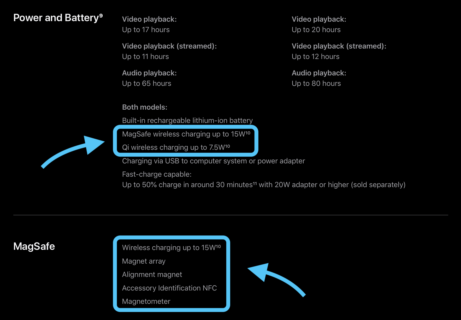

It is all controlled by the iOS software, maximum for Qi charging is 7.5w and Magsafe 15w regardless of what USB-C block you have connected to it.

Yea curious if anyone tested the max draw for the different 12 models. I know my 11PM was like 22-23W. But now I see what you are asking. I don't think the W of the charger will increase the max for the wireless chargers. And then you lose due to wireless being inefficient. The 22-23W on my 11PM is when it is lower on battery with a 30W Anker wall charger with the cord right into the iPhone
