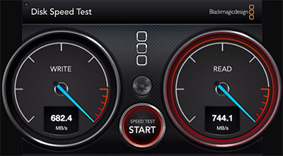

So I did a black magic disk test between an old T5 and the Fusion drive. The Fusion drive was faster on reads which makes sense. I ended up ordering a T7 and will report the speed test back. I can also do a sysbench disk test since I have brew installed. I'll send back the results to this thread in case anybody is interested.
Here's a 2tb T7 on my 2018 Mini
Have not tried the T7 on my 2014 Mini, but this is what I get with the older Samsung T3
