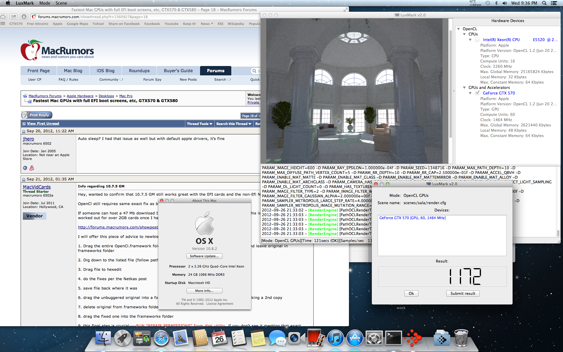

Do you have an apple gt120 to boot from and then check opencl and cuda on the gtx680 in non-gui mode?
