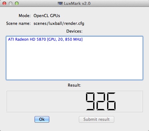

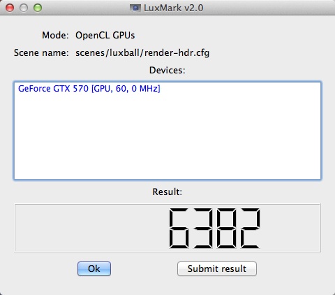

I just swapped my ATI Radeon HD 5870 with NVIDIA GTX570 (EVGA, 2560 MB) on a Mac Pro mid 2010 - OS X 10.7.4. Please note: In this case you DON'T need to order special Mac Pro 6-pin power chords, because the HD 5870 already has two of those attached. Just swap cards, the two power connectors: done!
I installed NVIDIA's driver (of course before swapping the cards) and Cuda driver (after swapping the cards): Cuda works.
Then I hacked the GeForceGLDriver (/Desktop/GeForceGLDriver.bundle/Contents/MacOS/GeForceGLDriver) according to Netkas: http://netkas.org/?p=1113 to get OpenCL support. This was a little harder, but worked too in the end.
OpenCL Benchmark with GTX570 (Luxmark Luxball): 6382 – compared to ATI 5870: 926. :)

ATI vs. NVIDIA benchmarks / NVIDIA crashes
It does look a little too good to be true.
You're right, different scenes, sorry. The right benchmarks for the Luxball scene are 926 (ATI HD 5870) vs. 992 (NVIDIA GTX570). For the Sala scene it's 754 (ATI HD 5870) vs. 923 (NVIDIA GTX570).
