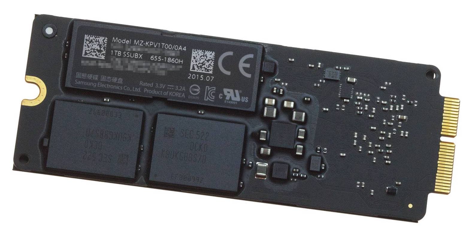

I've done upgrades with these PCIe Flash storage drives in MacBook Pros, Airs and Mac Pro towers. This is the exact model you want:
Model #: MZ-KPV1T00/0A4 1TB SSBUX
Apple Part #: 655-1860H
Is the 1400-1500 mb/s Read and Write claim true if I install this in my MacBook Pro?
Is there a fitment issue?
As you've installed them, id appreciate your input!!!

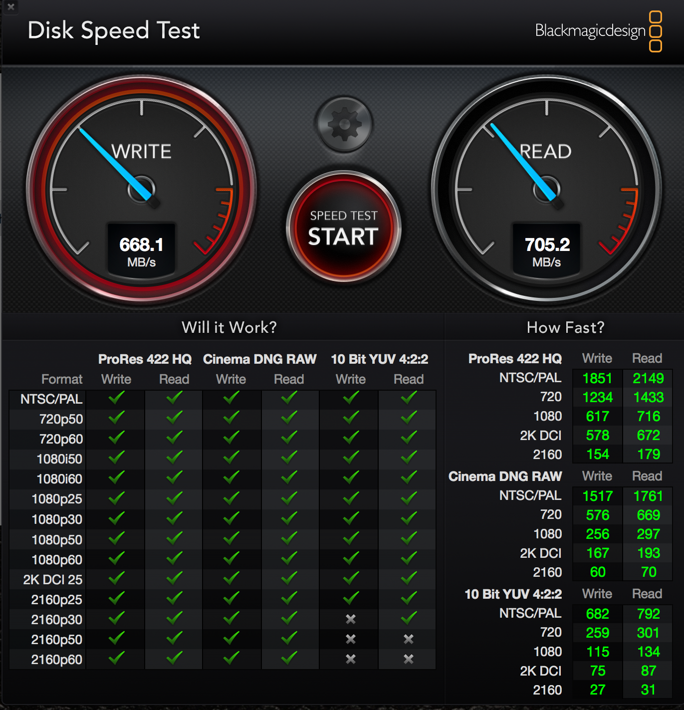

Downloaded Carbon Copy Cloner, and cloned my old SSD to an external USB.
I also have a Time Capsule, and was unaware of how incredibly EASY it would be to Restore my MacBook Pro from it!
I drove ALL over town yesterday trying to locate an OWC Envoy Pro, to basically test out the new SSD before I went all the way through with the swap. Sort of a redundant thing to do, but felt safer.
(Anti Electro-Static bracelets are hard to find here too, but Best Buy carries them strangely enough)
DID NOT really want to spend the 100 dollars on something id use only once (Envoy Pro).
SO, I highly recommend simply restoring from Time Capsule, (if you have one) upon the new SSDs recovery boot, and going to bed.
I woke up this morning, ALL DONE!
So easy to restore from TC, but the USB clone is a nice safety net to have in case something goes wrong.

It wasn't the CHEAPEST way to go about adding 1TB of storage, but the way I looked at it was this;
No matter WHAT external storage I ended up with, I WOULD NOT be able to transfer things as fast as the external SSD possibly could (some 1500+ mb/s with todays SSDs) BECAUSE of my old internal SSD speed.
Upgrading the internal SSD to a speed thats a little more up to snuff with the "NEW" MacBook Pros, and other competitors on the market, while gaining a TB and have external storage/PCIe expandability for my mobile music rack. Im happy 🙂

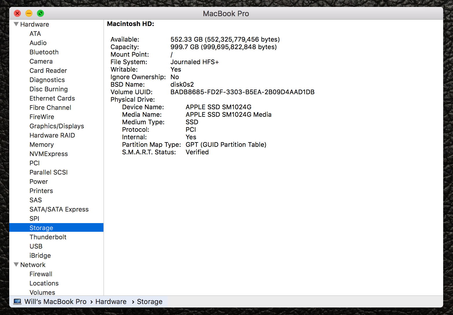

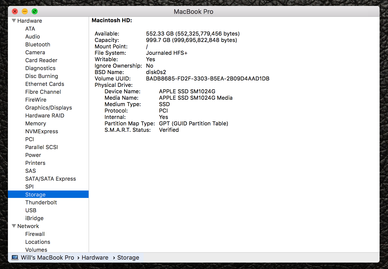

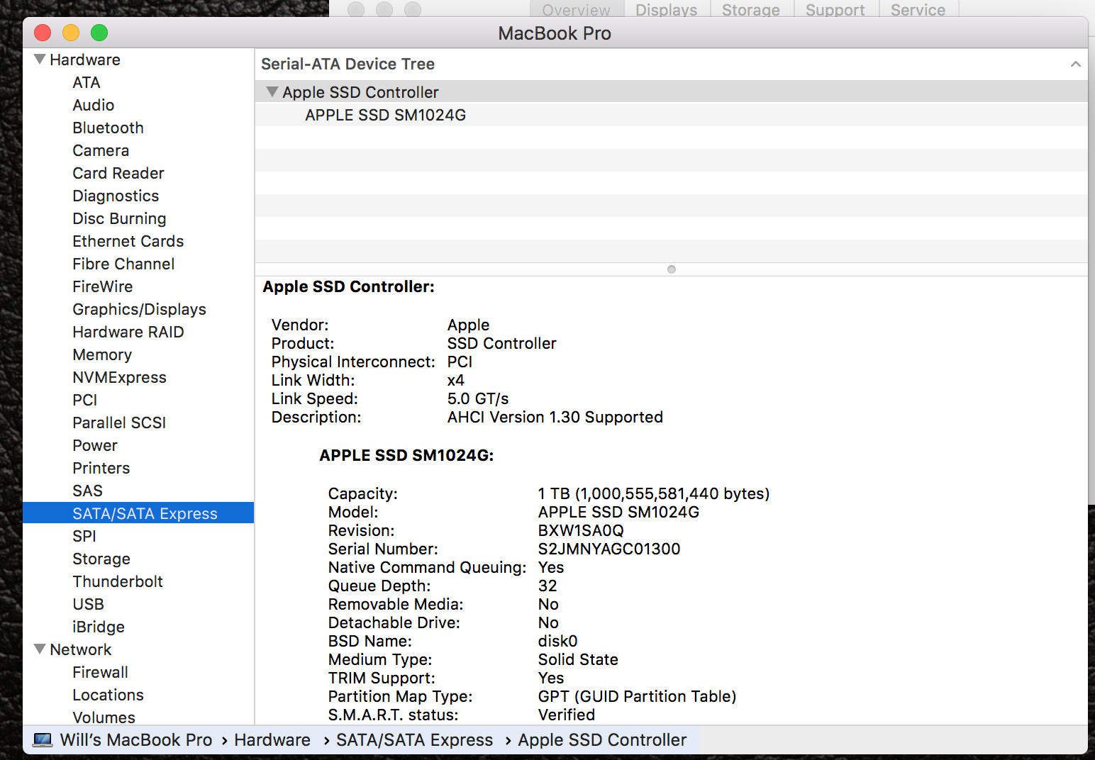

[doublepost=1492358456][/doublepost]I will say, under System Report, I DO NOT see where the new SSD is TRIM enabled...
Any recommendations?
That should show up there, right?
