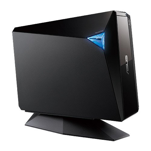

I can't suggest a different drive because I am not familiar with all of them. But I would venture to guess that you are experience the effect of Rip Lock, which most drives have incorporated to limit the ripping speed. My Plexar does does about 3X max but is rated higher.
