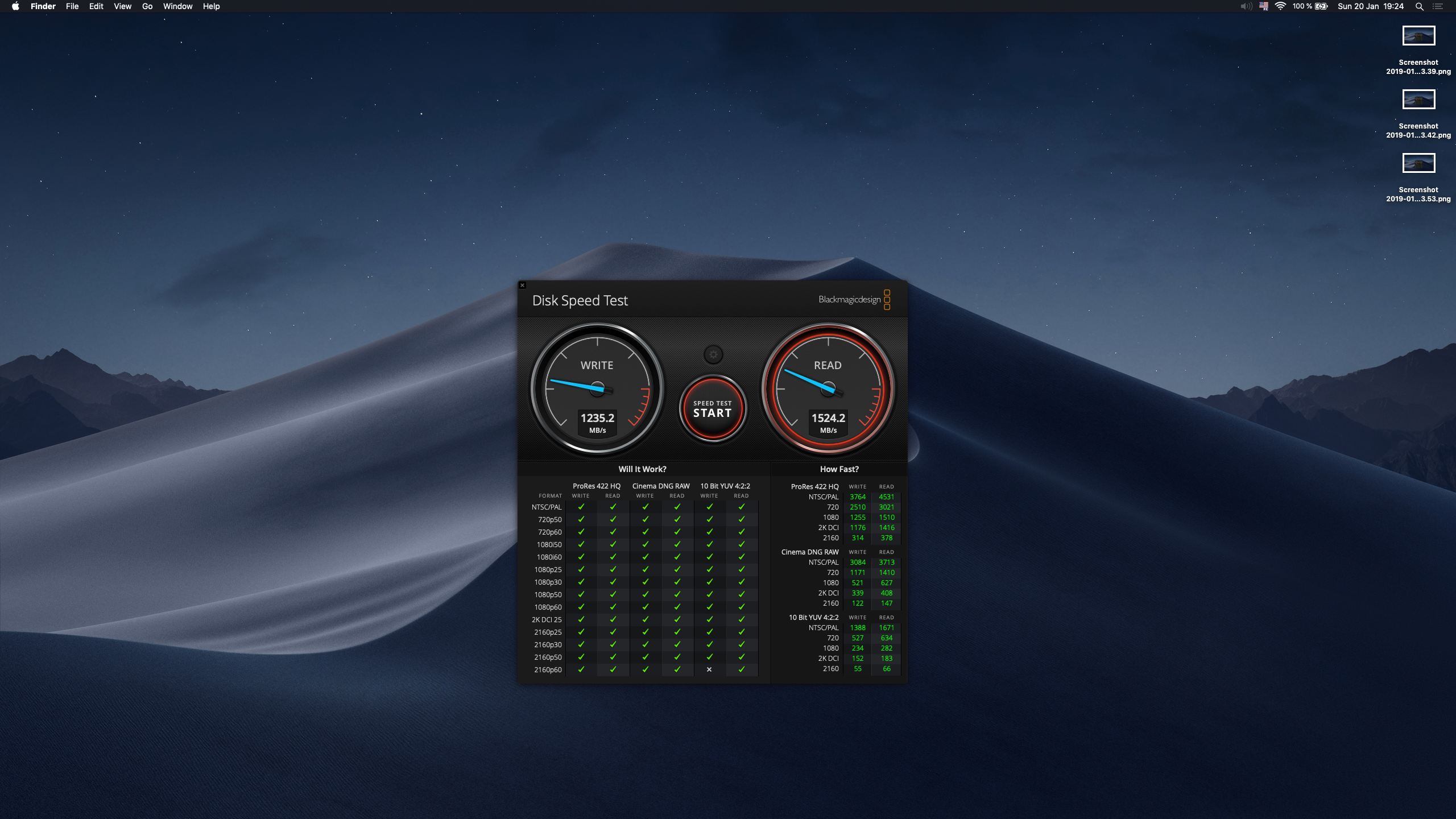

Hi
All worked great, sleep works without issues!!!
i went from aprx.
Write 200 MBs to 1200, thats a 6x boost in write performance
and
Read from 600 Mbs to 1500, thats a 2.5 boost in read speed
