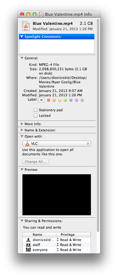

Never encountered anything like that with Subler. What version of Subler are you using? You have watched the original mp4 to make sure it doesn't do the same thing, right? Very weird. Have you tried redoing it? What was the source of the mp4? Handbrake?
Thats the mp4 movie.

Did you check the "64 bits chunk offset" when you saved it with Subler? If not try it again with that checked and it should work fine.
I tried it and happened the same thing.
1)Then i tried 4 new movies with default settings (no 64 chunk) and all of the worked fine. Do i have to always check 64 chunk?) So it seems the problem happens only with this movie...
2) I noticed that with this movie when i drag n drop files the other settings->hd->goes to 1080p... i checked it back to No and same thing happened... blank screen after some minutes of playing.
64-bit chunk offset is only required for files over 4 GB. It's off by default because older Apple devices aren't compatible with 64-bit files.
