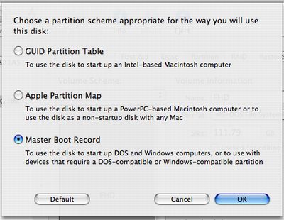

If you haven't done so, you'll need to configure Disk Utility so that it writes an MBR to the disc. Then you'll be able to partition it as one MS-DOS partition that a PC can read.
This is what I need to do.
I tried connecting to the PC TWICE, and still got nothign in the hardware list.
