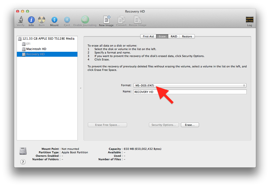

I would use Disk Utility to format it as FAT32. The only real issue with this format that most people will run into is the 4GB file size limitation. Beyond that it's typically fine for storing files that are accessed by both platforms.
You can find Disk Utility in your /Applications/Utilities folder. When you open Disk Utility you should see a list of hard drives on the left, select your external hard drive. Selecting the erase tab in the right side of the window will give you a screen similar to this.
Change the "Format" to MS DOS (FAT) and give the volume a name. Once that's done you can click erase. This WILL remove all data from the drive so be sure you've copied off any important data to your PC first.
