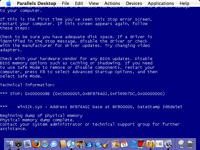

I use Parallels and while on XP every so often a fatal error blue screen will appear and restart my XP, not the whole notebook. The restart takes about 5 minutes but that is not the factor, the main part of this is I loose a lot of work because I use this Macbook Pro as a business tool.
Attached is a screenshot of what happens

A BSOD (or blue screen of death) can be caused by several situations. In one case, programs running at any given time can have conflict and crash the system. In this case, you should try to identify the faulty programs and avoid running them at the same time.
Hardware conflicts are the other major cause. You should make sure you're running the latest version of Parallels. If you contact the Parallels support department, I'm sure they'll offer some assistance.
This error has been linked to graphic cards in the past, if you're running Parallels 3.0 and have enabled 3D acceleration, you might consider turning it off.
Is there anything related about the crashes? Anything you might be doing, no matter how vague. Also include your Parallels version in your next post.
I have contacted Apple and Parallels and they have yet given me the correct directions on how to fix this. The Macbook Pro is no more than 30 days old as well, so I am sure it is not hardware related.
What is usually run while the crash occurs is Macromedia Dreamweaver MX 2004, AIM, Google Talk, and Mozilla Firefox. Also I have noticed that when I go into any of my documents, the folders are darkened by black, and only some folder icons appear. I have gotten a Microsoft Error a couple times while opening Firefox, having me send a report to Microsoft (screenshot: http://i11.tinypic.com/6eypt1c.png - *Manage Attachments is not working) and once the error is sent, another pops up and so on until I have to choose to restart.
