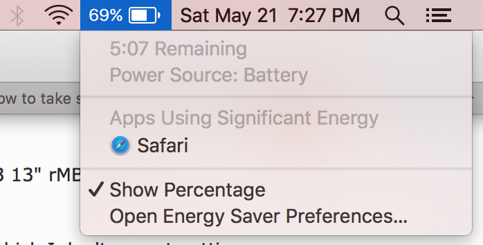

There might be something wrong with your battery. This what my 2015 rMB shows:

I've been watching Dropbox, Adobe Creative Cloud and Google Drive. None of them jump above 3% CPU usage.
My percentage stuck at 83% (4:51 remaining) for about 30 minutes. Then it dropped down to 80% (5:51 remaining) for the last 15 minutes. Obviously don't want to take into account the numbers so much, but I'm confused why it's a) sticking at various percentages for such a long period of time, and b) not recalculating the time remaining each time I check the battery status.
Here's a screenshot of my battery info. Not sure what is relevant though.
Skylake has much higher load power consumption than Broadwell, and the M7 in your 2016 rMB clocks up to 3.1Ghz and probably draws >20W for short periods. It wouldn't surprise me at all if the 2016 M7 had substantially worse battery life under load than the 2015 rMB. Standby power consumption should be slightly better, but the lack of FIVR in Skylake means the VRMs are all on the motherboard and are much less efficient.
That said, your quoted battery life of 6 hours is way too low for a discrepancy between skylake and broadwell, so I think your battery is probably borked.
