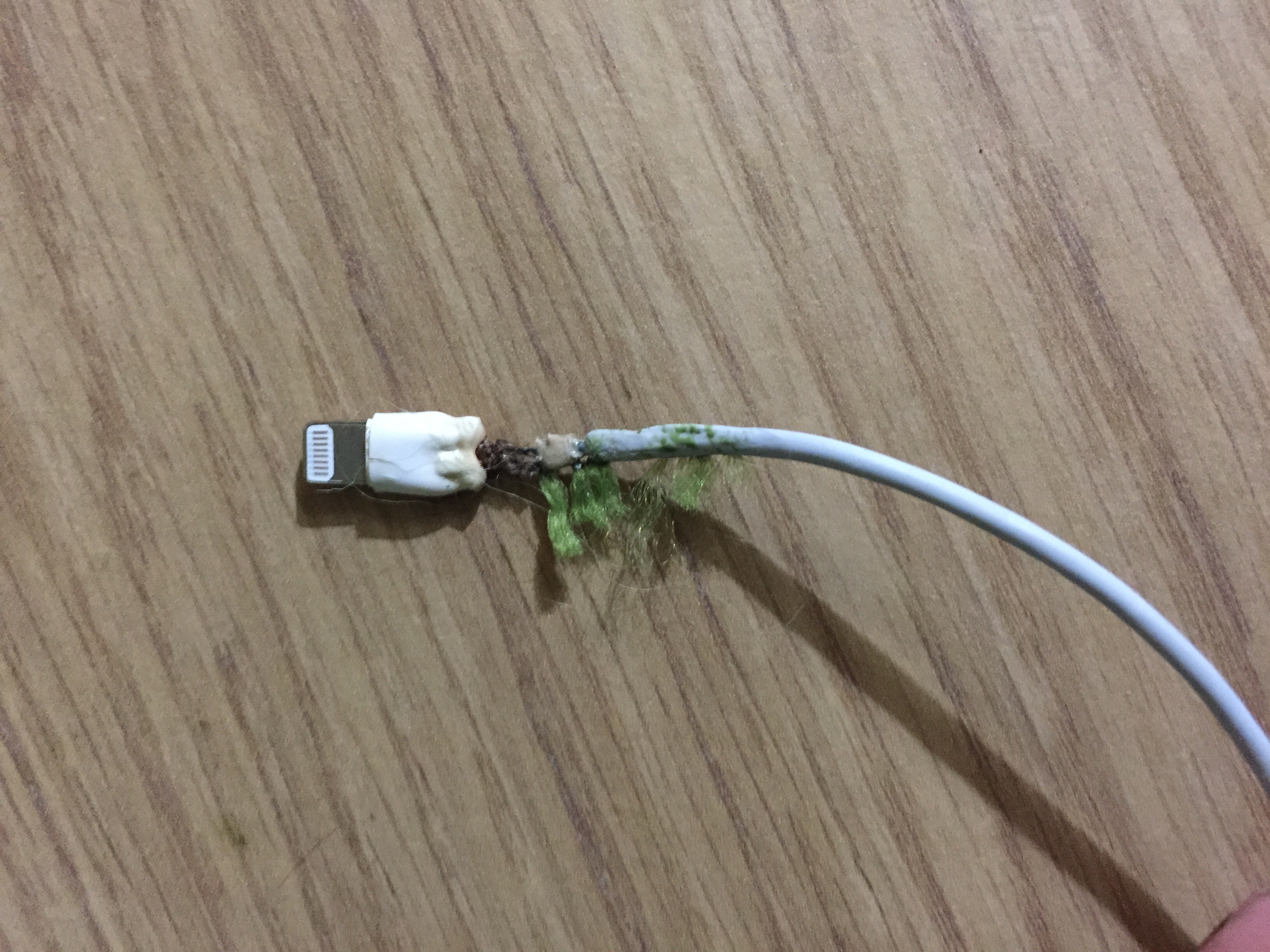

Has anyone experienced this with their lightning cable??
Left my iPhone 5 on charge, I could smell burning and quickly unplugged it. I wanted to know if anyone had the same??

Yes. Genuine
Where'd you get the cable from? Don't say it came in the box. It didn't. I'm not blaming you but it's not genuine based on your image. You suffer from owning an unsafe cheaply made Chinese knockoff.
Here's why:
1. You can CLEARLY see an outer metal band around that lightning connector indicating it's a two piece design. Apple's connectors don't look like that. At all. They are a single piece of metal.
2. The white portion with the pins is absolutely the wrong shape.
3. I bought some cables online that were marketed as "genuine" right when the iPhone 5 came out. They looked just like the one you have.

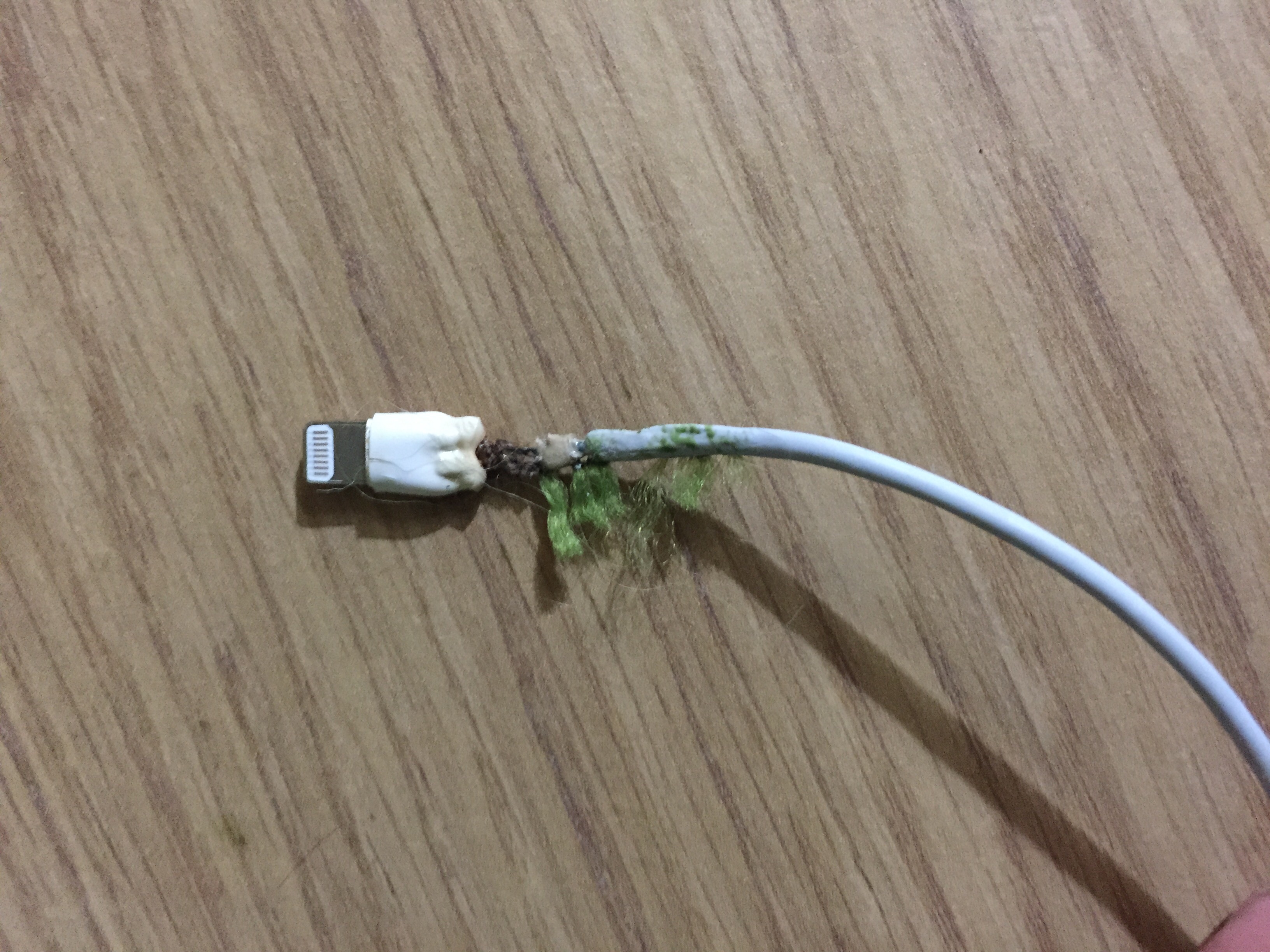

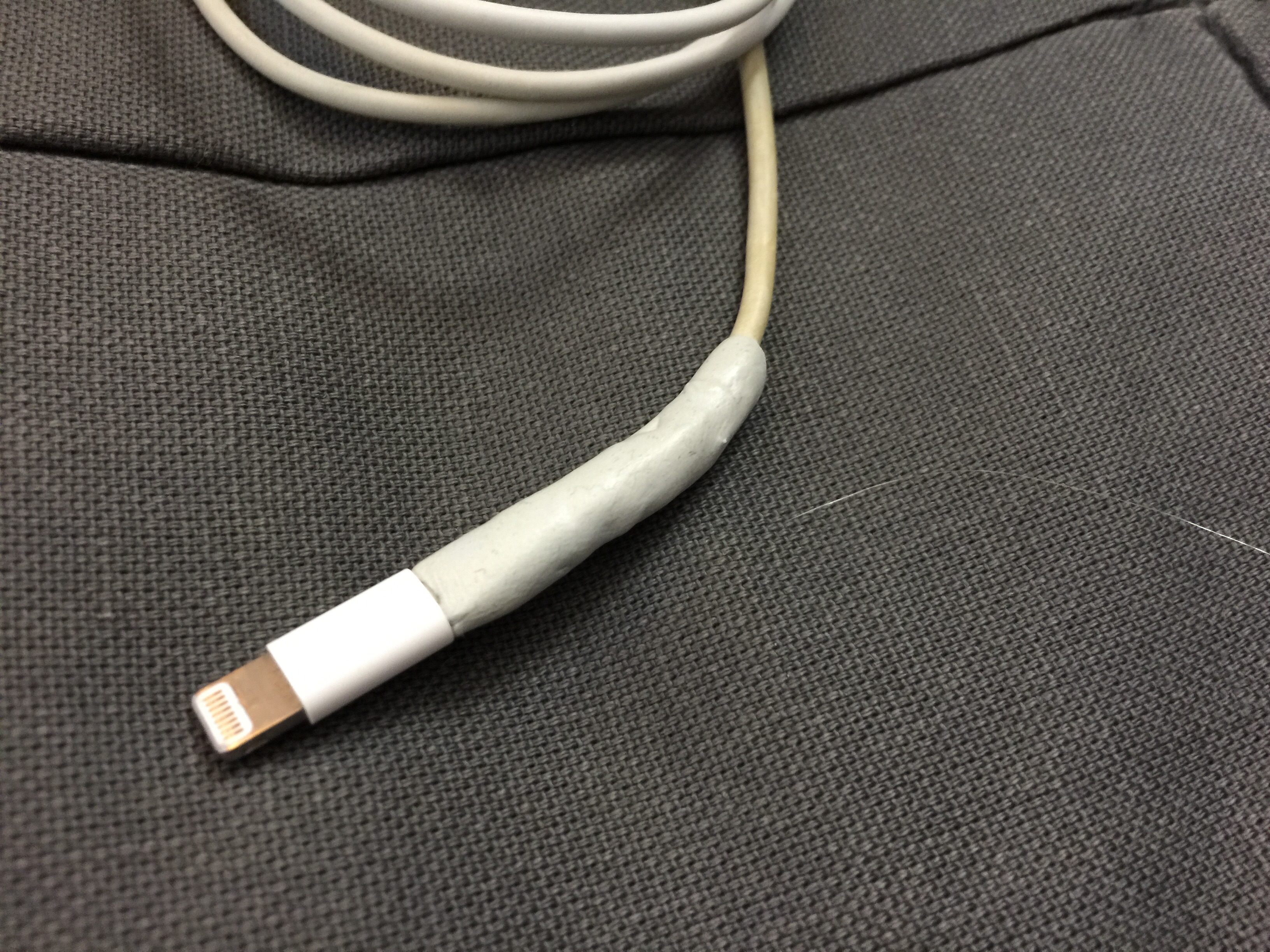

OP's connector
Genuine Apple connector
Like what Bubbler328 mentioned, that's a fake cable for sure. The original cable's white plastic portion where the pins are aren't shaped that angularly. My guess is that your fake cable + possible fake charger did that.
