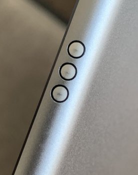

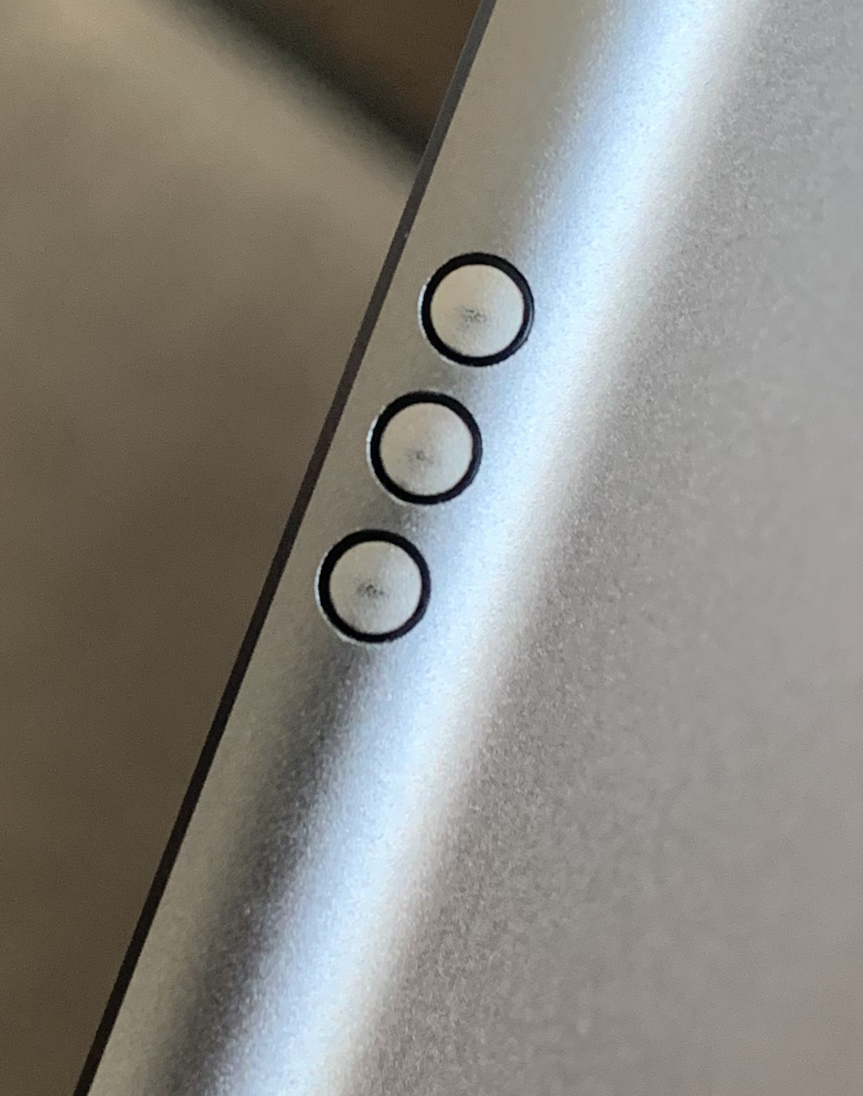

I have an iPad Pro (10.5) and the Smart Keyboard stopped working a few weeks ago all of the sudden. However the pins look fine. Since I cannot go to the Apple Store for obvious reasons, I already ordered the new logitech keyboard with the trackpad as a replacement but now I am starting to wonder if actually the smart connector itself might be faulty and not the Smart Keyboard itself?
Is there any way to test to see if the smart connector works as it should? I assume there is no hard ware test on iOS. don’t want to spent 149 € on a new keyboard only to find out its the iPad that’s faulty. right now I could still cancel the order
edit: I am kind of worried by these „scratches„? (attached) but I swear I never dropped it, must be the result of the Smart Keyboard usage.

Those little black dots on each pin?
Yeah.

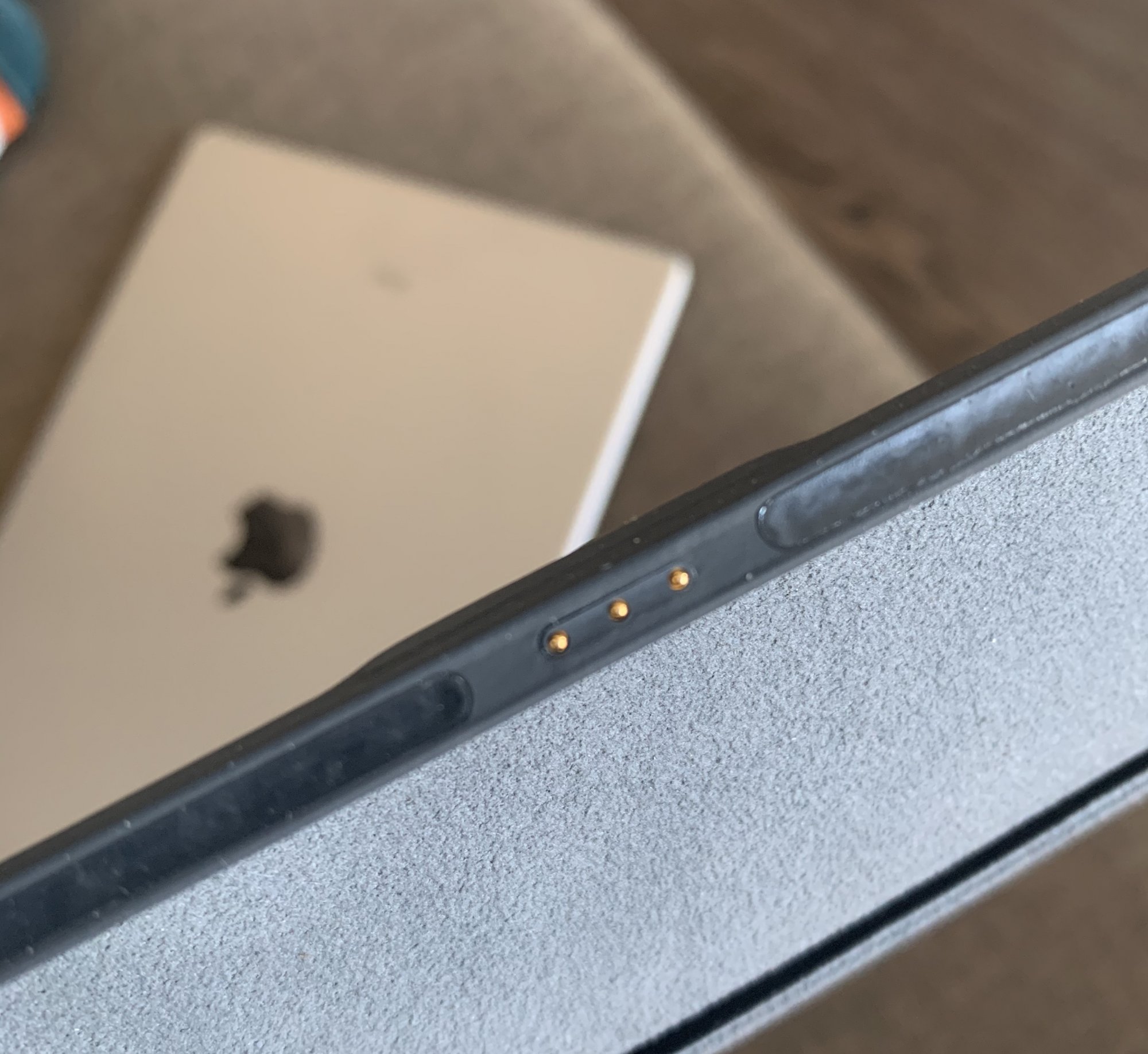

It is probably from the Smart Keyboard. It also scratched the iPad itself ... I can literally see the silver of the iPad on the fabric of the cover.
i tried to wipe it off from the smart connector but seems to be permanent. You think that could be broken?
The Smart Connector is just three metal contact pads. It's not likely it would be faulty when compared to the possible modes of failure in the keyboard. If the fault is in the Smart Connector, most likely is that there's a buildup of dirt/oil on the contacts (functioning as an electrical insulator) - wipe it down with a clean, dry cloth first. If that doesn't help, try wiping it with a cloth lightly dampened with 90-93% isopropyl alcohol.
