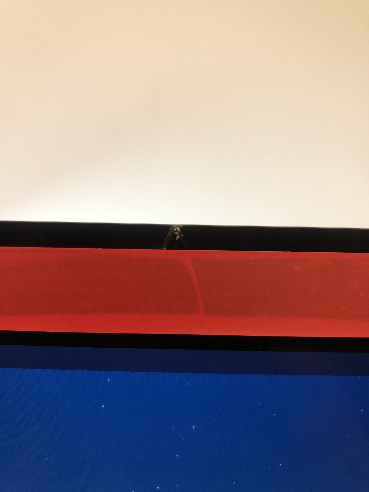

During the opening of the screen, I made accidentally a small crack on the upper side of the screen (looks like a bezel) that broke me 😭

About the crack, it is actually the glass (bezel) that is cracked a little.
Now I need to find where I can buy a new one 🙂

However, I think the glass is fused to the LCD on this iMac, so cannot be separately replaced. I'm not sure about that, but you may not be able to do much about it.
