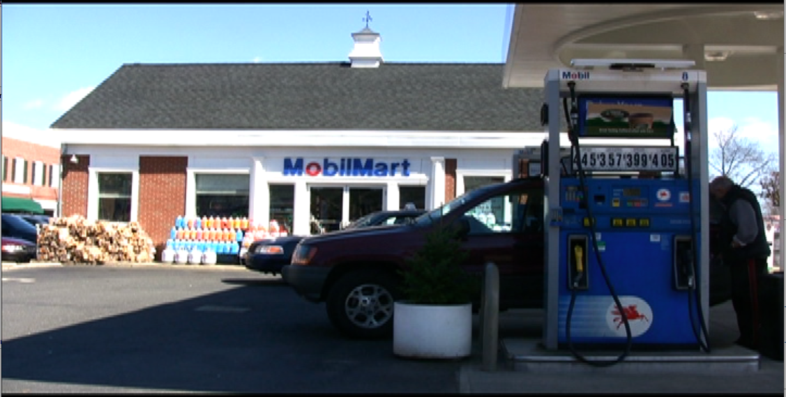

To extend, to put it into some perspective, here is the Apple Intermediate Footage (the source footage):
And here is the footage after Export to Quicktime Movie:

Well thats why I showed the screenshot - is that acceptable? Should the export afterwards look like it does now?(not saying in a condescending way at all, i really want to know)

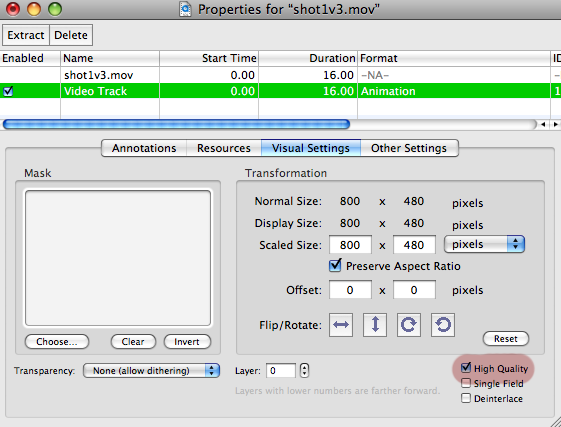

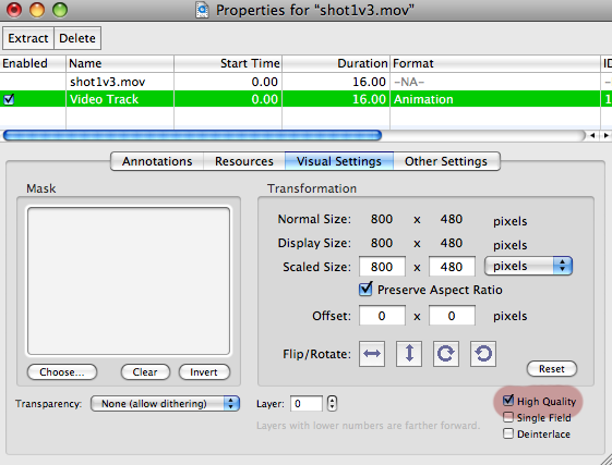

Its probably a quicktime setting. Usually happens when exporting DV or some other low compression setting.
Press Apple+J, then make sure "High quality" is checked on.
