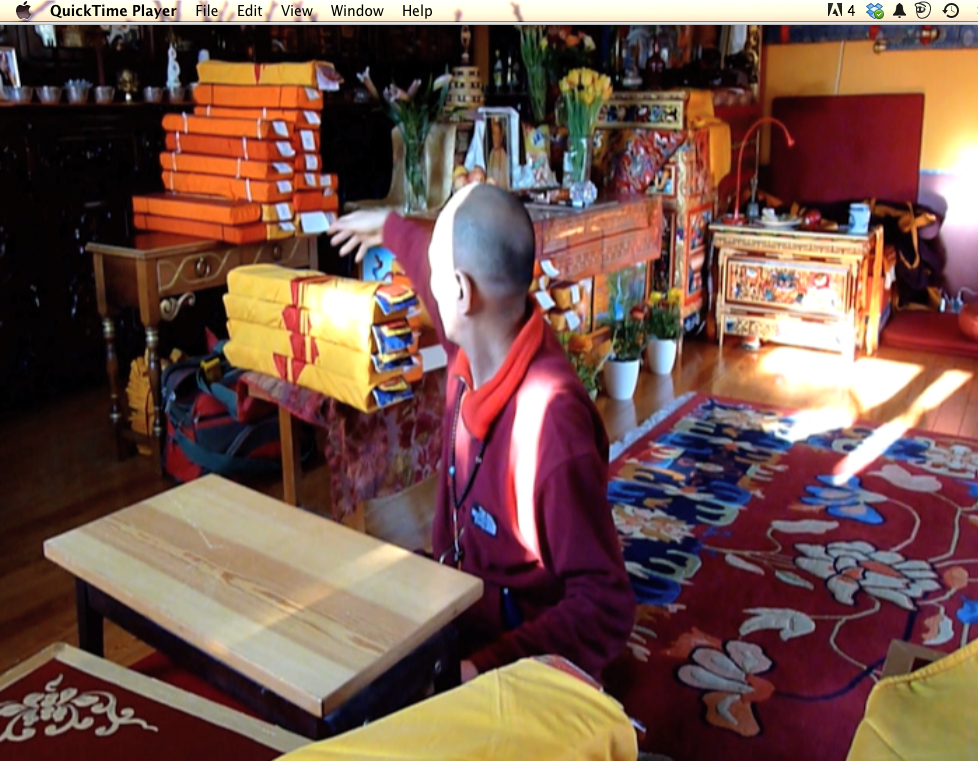

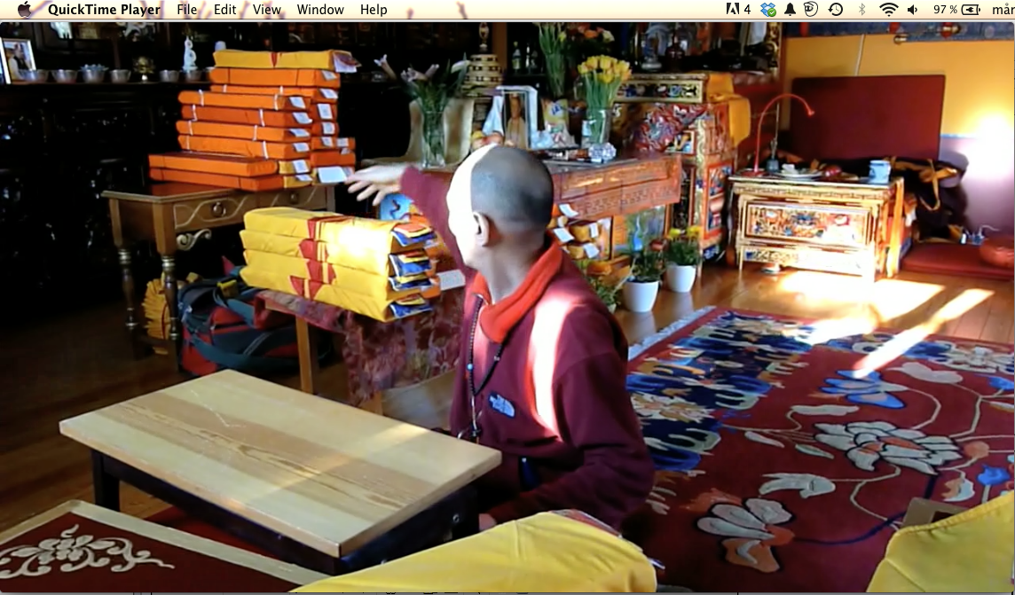

Also, could you post a screenshot from the video before and after exporting? Same frame if possible. Just so I can get a picture of what exactly is happening.
No problem.
The difference is not big but it is still clearly visible when it comes to the color burgundy and the orange.
I do see what you mean, especially in the orange cloth (?) folded on the table.

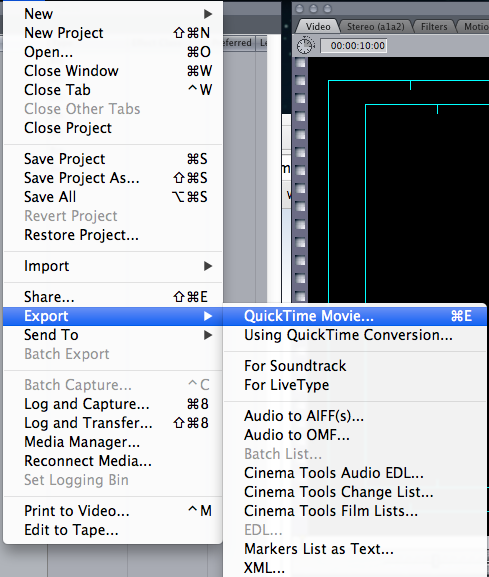

THEN.. what I was suggesting is to export the sequence at its native settings from FCE.. which means do NOT choose a different setting as you listed, merely choose export.. (I have never used FCE, just FCP.. but below is what you want to choose, assuming its the same)
choosing this exports your edit at the original format of what the sequence is set at.

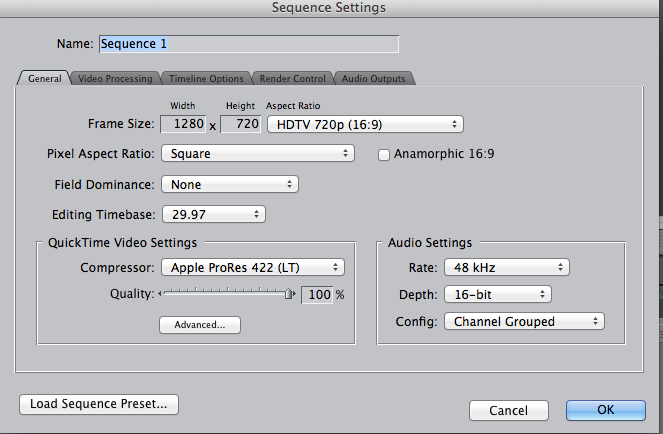

In my case the sequence setting were the ones below. Are they 'good'? What decides them, is it by default?
In the timeline the sequence had these properties:
frame size: 1280 x 720
vid rate: 25 fps
compressor: apple intermediate Codec

as for your sequence settings.. does that match your footage?
meaning.. are your clips (either digitized off of tape, or imported from a camera) made at that codec? (apple intermediate) or are they different?
I ask this because i've seen countless editors editing in mis matched enviroments.. your sequence USUALLY should match the majority of what your footage is.. this helps for playback and less rendering.
This is also important so your not rendering when you may not need to..
and there is a chance that your color looks off because of that codec.

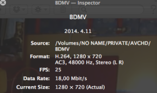

When I clicked on the file on the SD-card from my camera it started playing in Quick Time Player, I pressed cmd + I, and this came up? Is that the information concerning the original footage or is it only related to Quick Time?
