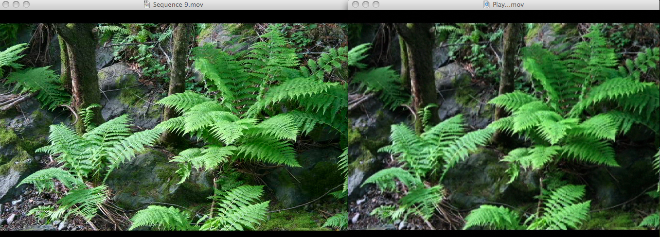

Ok, I've got a comparison screen shot: new vs. old
Hi rez Image placed into 720 x 480 timeline
Exported using QT movie
= Image on left
Old movie in need of rescue, unknown resolution
Exported using QT Conversion, quicktime movie, option changed from 477 x 356 to NTSC 720 x 480
= image on right
[Image on left is close to Windows MPEG-2 results]
the image on the left looks fine, so open up the sequence settings of the trouble sequence and change them to the proper (720x480 DV/NTSC) settings.
We're back to my initial question.
I get the same poor results as the image on the right after opening the trouble sequence and setting sequence properties to 720 x 480 and then exporting using either QT or QT conversion.
I can only get the results on the left by placing an image in a new 720 x 480 timeline.
Do you know a way I can rescue my movie? It's nearly 80 images with intricate transitions...
