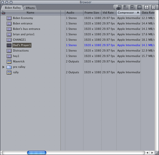

yes it does!
I shoot with a canon HF-10 and below is the screen shot of my import and the timeline settings using FCE4 (after the latest update that makes it 100 times better to edit this footage).
(footage was from a Biden rally here last week. My dad was invited to do the invocation, hence the clip titles).
