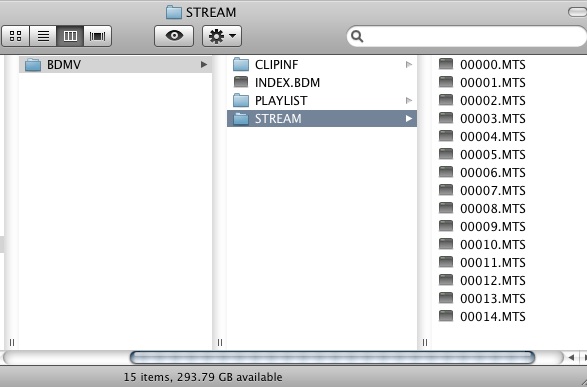

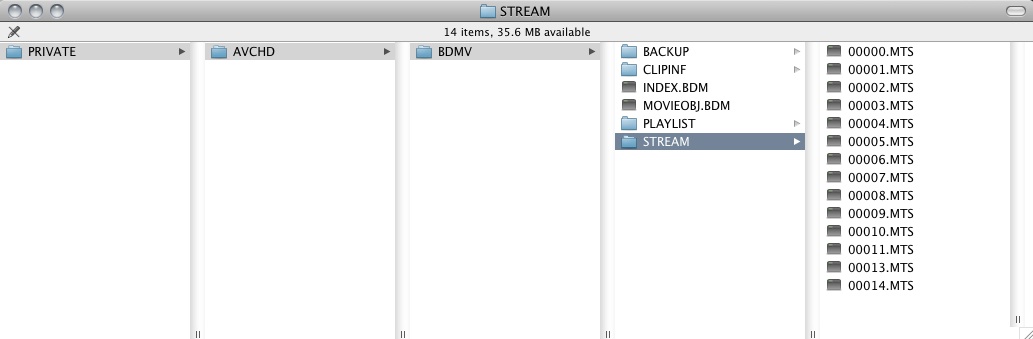

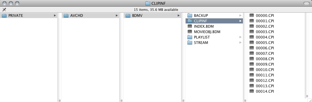

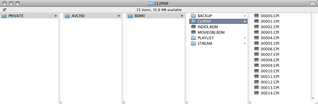

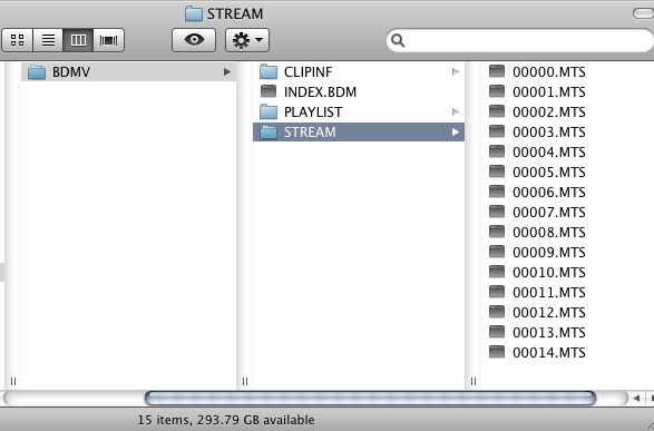

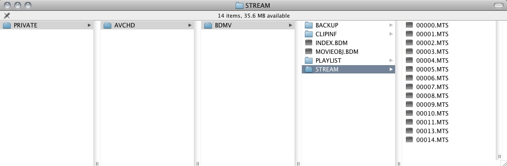

Attached are three images which are from a Canon HFS11 AVCHD SD memory card:
1. This shows the CLIPINF folder with 00000-00014.CPI files.
2. This shows the STREAM folder with 00000-00014.MTS files BUT with 00012.MTS missing.
FCE 4 would NOT Log and Transfer this folder (you can choose Add Folder from Log and Transfer and choose either the AVCHD folder or BDMV) without the .MTS files matching the .CPI files.
NB: If anyone can tell me how to edit or view the INDEX.BDM file I would love to know.
Image 3 shows the bare minimum structure for FCE 4 to Log and Transfer. SO, if you have .MTS files lying around without the folders, make the folder structure yourself like in image 3 and then you may need to get INDEX.BDM file off someone, MATCH the amount of files that would have been shot (don't ask me how but in my image 3 there are 15 files for i knew how many were shot) and will also need the 00000.MPL file that sits in the PLAYLIST folder (not shown).
I made up a complete fake folder from ONE .MTS file and ONE .CPI file by duplicating them 14 times and changing the names to be in sequence. IT WORKED!
