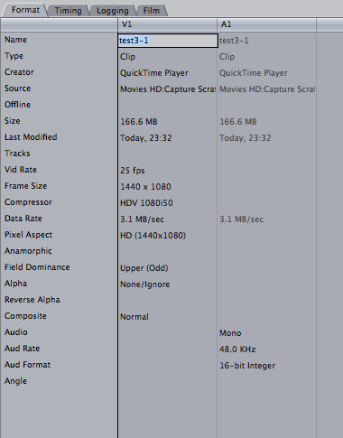

Yes I am having the same problem as superspiffy. Still have to render the frames from my HDV-HC7. I did not have that problem with the HC3 camera.
Is'nt there somewhere on the internet a list of camera's and the best sequence settings for fcp? I have tried about everything and still the program says I have to render.
