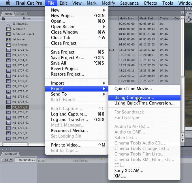

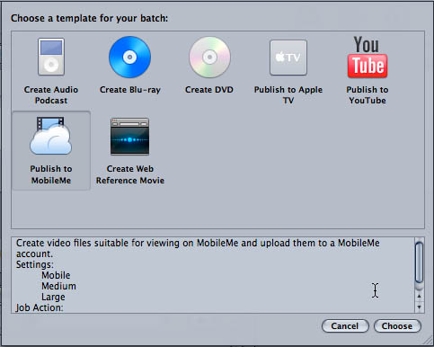

Have you tried the Compressor YouTube preset?
