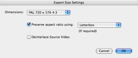

You'll need to export from FCP using the Quicktime Exporter, in the Options window under Movie Settings you'll find a button marked "Size" in there is a check box for "preserve aspect ratio using:" and then a drop down that includes the ever wonderful Letterbox option!!
Select PAL 720x576 4:3 for dimensions, and then letterbox for preserved aspect ratio, you'll get a new video in 720x576 that plays your original content back correctly letterboxed in the 4:3 aspect ratio.
I'm not sure which codecs Toast likes, but DV Stream is a good bet, if not H264 is probably your best bet. The problem lies in the way Toast deals with the MPEG2 encoding which must be a 720x576 4:3 aspect image.
This should cure the problem, or you could simply use iDVD to author your work.
