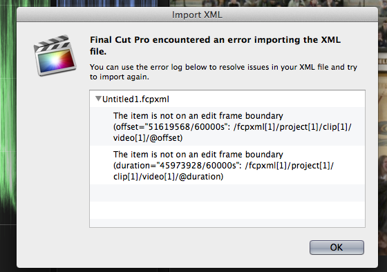

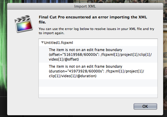

issue 2: I get this random XML error... any ideas what the means?
