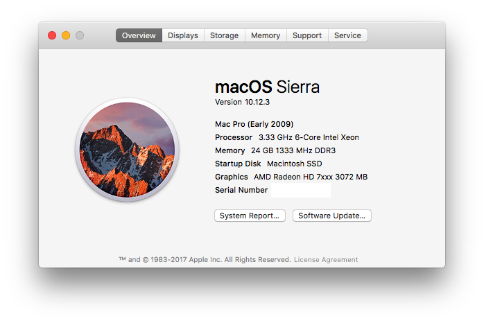

I have FCPX on my 2009 Mac Pro (see pic) updated to 3.2 but didn't do any real work since v10.2.4.

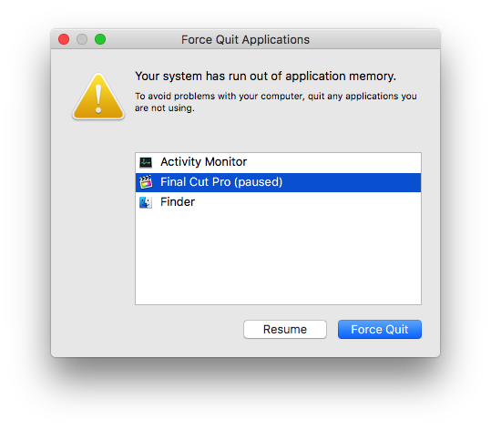

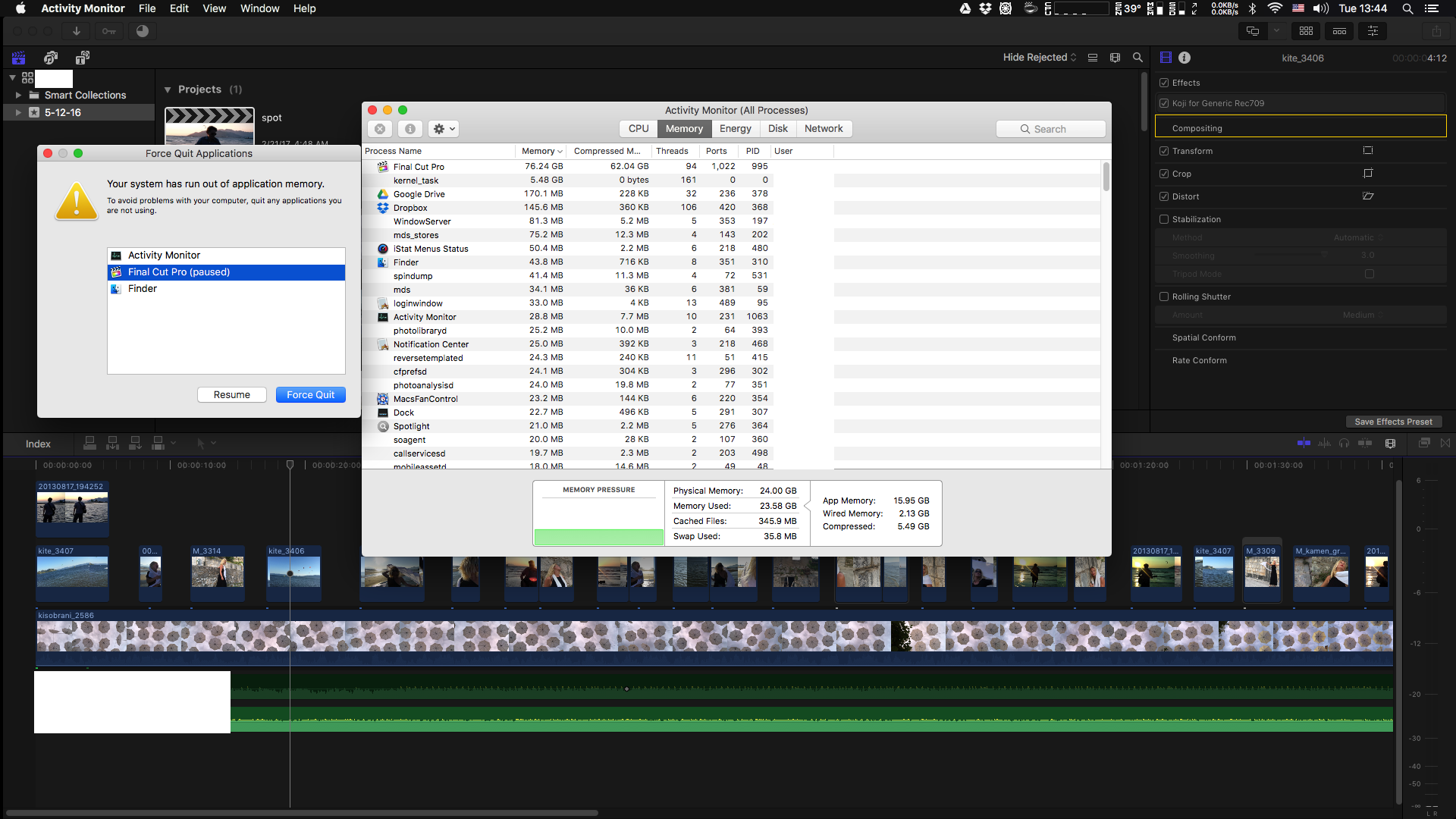

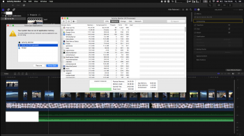

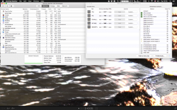

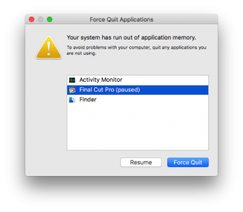

So I fired it up, loaded project and let it do the rendering. After few minutes I got back to the Mac just to see message Your system has run out of application memory and the only thing I could do is Force Quit FCPX.

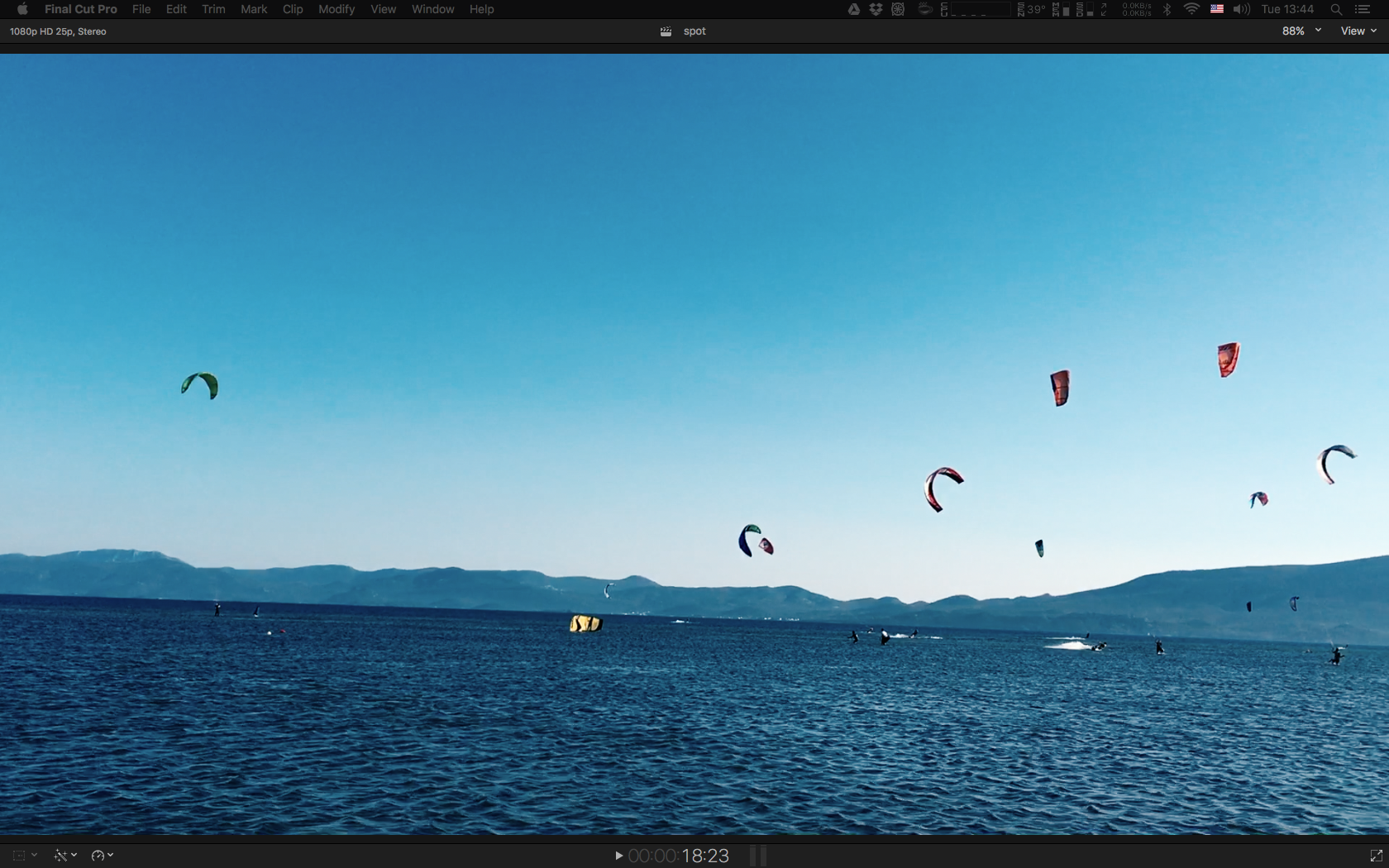

Here are screenshots I've taken before quitting
Screen Shot 2017-02-21 at 1.44.33 PM.png Screen Shot 2017-02-21 at 1.44.33 PM (2).png Screen Shot 2017-02-21 at 1.45.10 PM.png
As you can see Activity Monitor was reporting FCPX memory usage of 76GB memory (62GB compressed) .

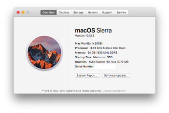

Here are spec of my cMP
GPU is R9 280X but at the moment I'm using stock UEFI rom since I'm booting into Win10 EFI installation.

Definitely looks like a bug. It's eating a solid 80GB of RAM!
You're running the latest OS and (I assume) the latest version of FCPX? I'm just wondering if the problem persists when you're loading up an older project made on an earlier version of FCPX, or if the issue also occurs when creating a new project?
The only possible thing I can think of... maybe... is that you have loads and loads and loads of previously imported content in your collections and somehow some bug somewhere causes... something to happen. But even so that wouldn't directly cause the problem as it's not a known issue.

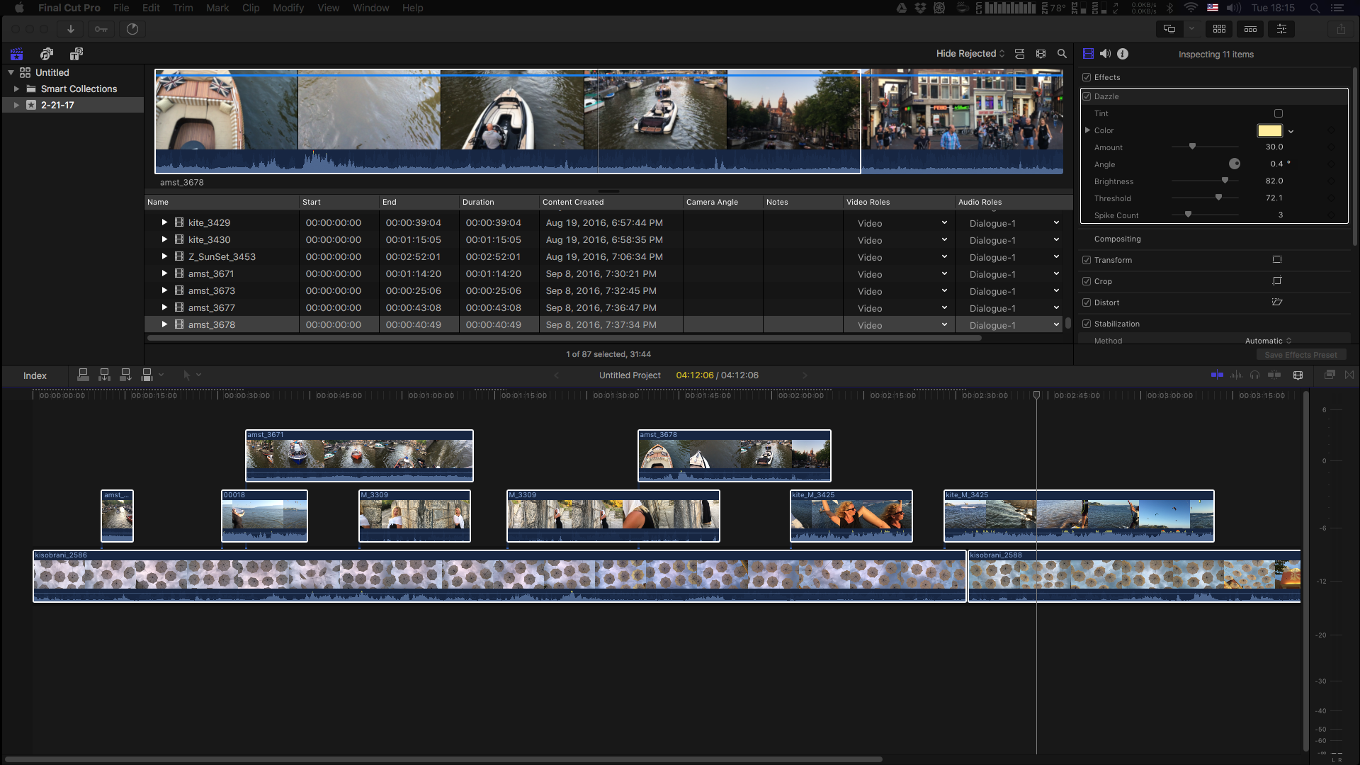

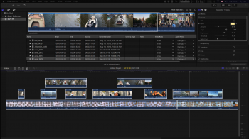

In the short time i had to test your ideas, it seems that old(er) plugin is causing those memory leaks, so i hope everything is ok with Sierra and latest FCPX. The one i managed to isolate is Koji Color and i'm 99% sure that it is causing the problems because i saw that they advertise on their website Sierra ready update.
I will report back as soon as i get back to Sierra, but i managed to try and run as much FCPX effects and stabilization on the same clips before, without Koji, and all wen't well for more that half and hour. FCPX never 'took' more than 3GB of RAM.
Screen Shot 2017-02-21 at 6.15.47 PM.png Screen Shot 2017-02-21 at 6.15.47 PM (2).png
