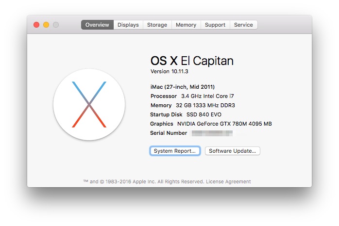

Here's mine;
iMac27 mid-2011, 32gb ram, 2tb raid0 ssd, gtx780m, elcapitan 10.11.3
render time = 19seconds

First, if your iMac has a GTX 780m, it's an iMac Late 2013, not Mid 2011.
Second, you report seriously a comparable result as with two HD7950?
Did you execute the benchmark exactly as described?
The most directly comparable iMac has:
Actually mine really is a mid-2011 27" iMac. I just upgraded it's GPU with GTX 780M with 2x 1TB Samsung 840evo in RAID0 setup. I did executed the benchmark three times and I got an average of 19 seconds.

Here's mine;
Impossible, and not matching with others result as well. (52s for single 780m)
May I ask you to try this?
1) Please make sure background rendering is off.
2) Delete the project.
3) Fully quit FCPX.
3) Remove all the FCPX cache files in finder.
4) Empty trash
5) Open FCPX, and follow the exact step of the test.
The result should be in 5K resolution, not 1080P etc.
mhafeez
macrumors regular
Oct 30, 2013
103
56
Did you this?:
3. In Final Cut Pro X, go to ‘Final Cut Pro Preferences…’ – in the Playback tab make sure ‘Background Render’ is off.
12. If possible do the export at least three times. Your configuration’s BruceX Score is the average export time in seconds. Before timing the next export, restart Final Cut (otherwise the exports speed up each time because X does a little caching renders to save time). -> Delete the project if Background Render was already on.
Where did you buy the GTX 780m 4 GB? :)
I got the GTX780m from ebay by seller named "ChooseYourDestiny" something like that.
3) Fully quit FCPX.
4) Empty trash
I have done several times again and again, followed all steps accordingly especially No.3 and No.12 as mentioned and I still got an average of 19 seconds. I think it is due to Apple's newly improved Metal.
h9826790
macrumors P6
Apr 3, 2014
16,362
8,341
Hong Kong
Can one more person confirm the 780m's FCPX performance under 10.11.3?
If this is true, this card should be the most energy efficient GPU for FCPX.
Even the Maxwell card seems can't give out this performance with just around 120W TDP.
Metal is there, but seems not doing much at this moment. And most of our cards also support Metal, I am not saying that you are lying, but have to find out if this 200% improvement is due to software optimisation. Or not running the benchmark correctly.
Can you post pictures?
