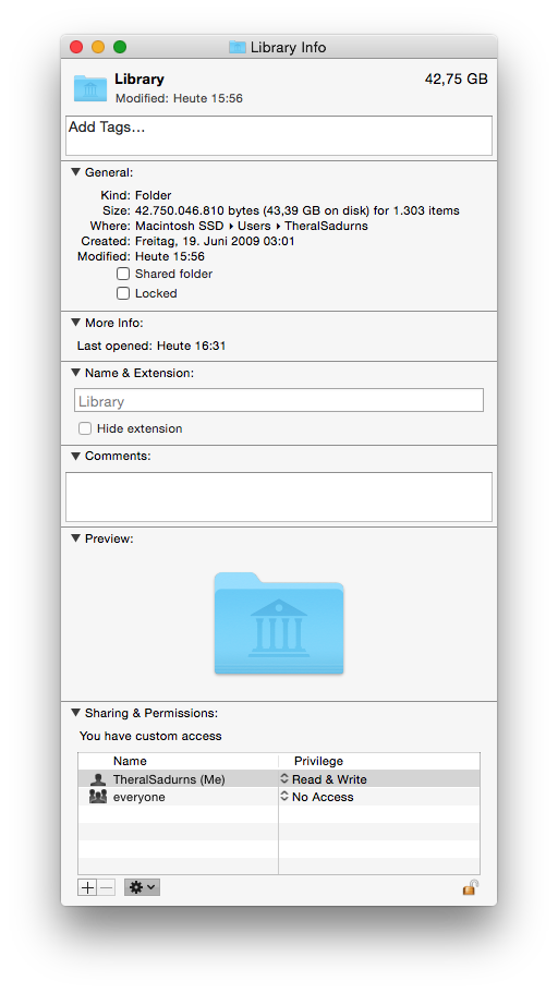

After reading and trying countless things the solution was relatively straight forward:
~/Library/ → Get Info... and set Read/Write Privileges for my own account and apply that to ALL ENCLOSED ITEMS, too!
After that... all peaches again!
