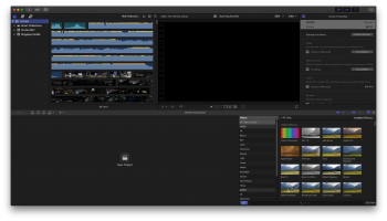

I know it probably sounds like I'm being stupid but I've opened and closed this project for 10 days straight. I've tried openign it through the left top corner - whichever event I open no timeline opens with it. I have tried opening it from finder too - the project opens but the timeline isn't there it just says 'new project'. I have moved the location to an external HD which is otherwise working fine. It looks like I havn't even started the project

I can't tell much from that screenshot, but it sounds like you are confusing the terms "project" and "library" for starters. In your screenshot, "Untitled" is the library name. Didn't you create a new library and give it your own name? If so, then that is the problem, you have not opened the correct library. Look in the Movies folder in the Finder. What files do you have with an .fcpbundle extension? If "Untitled" is the only one, then that must be where your project was created. Otherwise, open the other files and see what's in them.

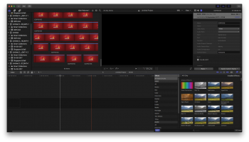

I have included the untitled project just to show what it is like when you have two libraries loaded at the same time.
I'm at a loss, I have a lot of 'untitled' projects with GMT + 1 etc. - I have 4 of these, I thought they were FCP automatic backups but I've only really been openeing the 'untitled' as I knew that was my project anyway.

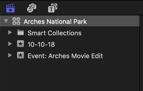

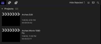

[doublepost=1542476709][/doublepost]Hello, I found this forum when I had a similar case (project missing).
I was able to find my missing project by clicking the "clapperboard with a star" icon in the top left area of FCPX. The two screenshots show what I saw before clicking the clapperboard icon and then the project that got revealed after clicking the icon.
Hope this helps as I was also confused for a moment and thought I lost my work, but glad to have it back.
